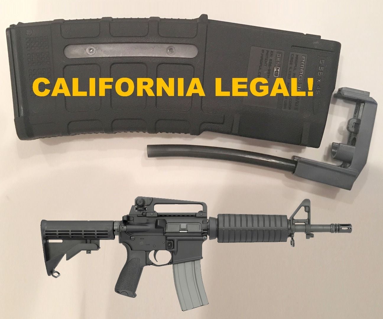

    Hey there I'm new here and am not familiar with the forum and couldn't find exactly what I'm looking for.
    I'm about to move to CA and I really trying to make sure I am complying with all of the laws and I found this instructable for making 30 cap mags into 10 cap mags. Is it legit?
    How to Convert a 30-Round Magpul PMAG M3 AR-15 Magazine for Legal California Use: WARNING! DO NOT ATTEMPT THIS MODIFICATION WITHIN THE STATE OF CALIFORNIA! It is illegal to import, assemble, or receive large capacity magazines. You must perform this modification outside of the state of California before bringing the magazine i…
    if this has been posted before I'm sorry, just point me in the right direction and delete this thread.

      New Gen M3 Pmag 10 round limiter or Magblock. Will limit new Gen 3 Pmags to 10 rounds.
      Do yourself a favor and just buy this part that's already made.
