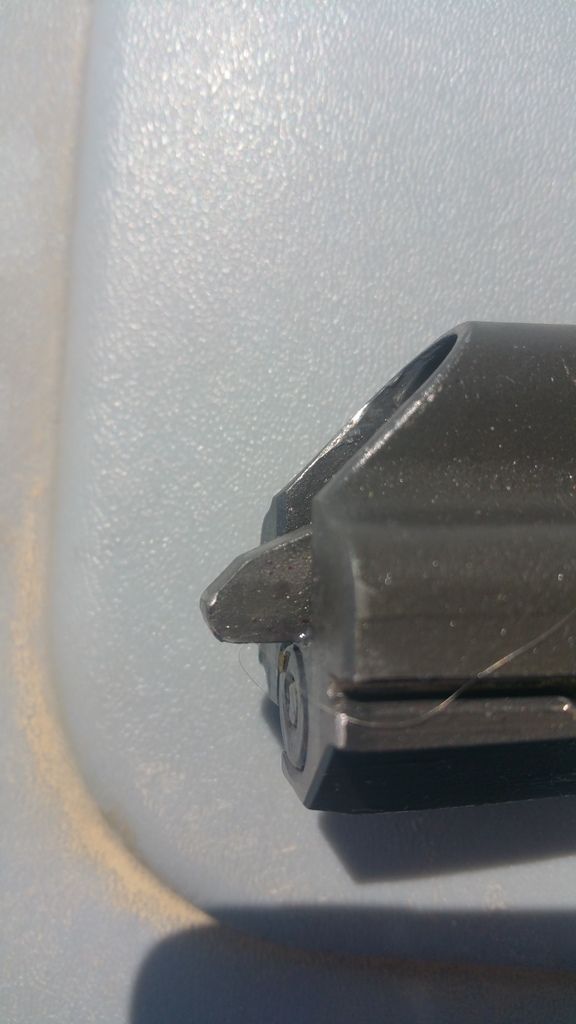

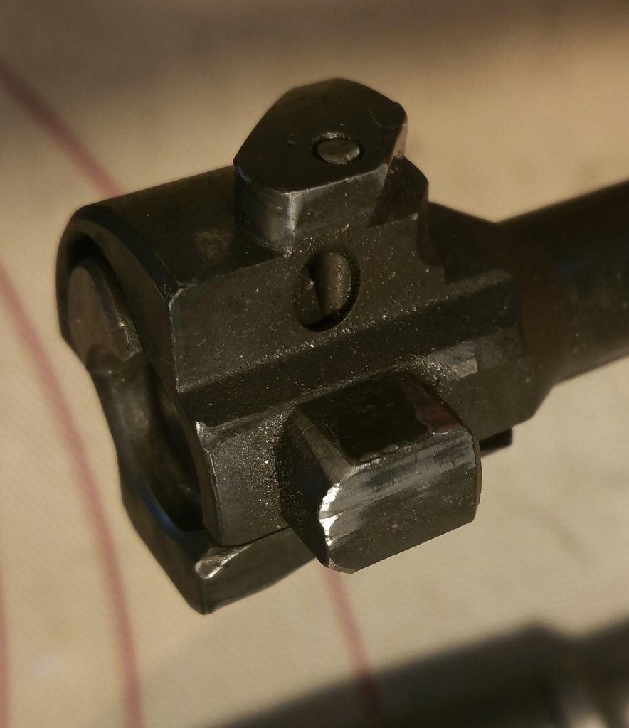

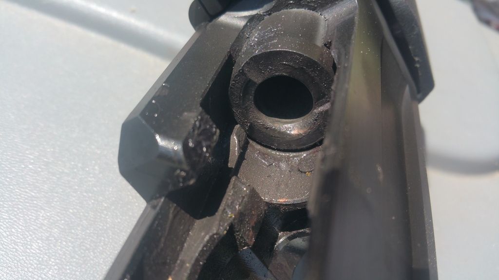

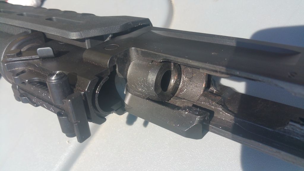

Buying the c39v2 was a terrible mistake that I have ever made in my whole entire life. The rifle irons was so heavily canted that couldn't even zero at a target 18M away... it shot far the the left and after about 100-300 rounds the right lug was penned and my dove tail had mushrooming. To make things worse the tail of the bolt is starting to mushroom as well. I sent my rifle back for service (canted sights) and also mentions to them about the mushrooming that I have and they fixed the irons (shoot straight giving me about a 1.5 MOA at 25m zeroing for 100M. Regarding the deformation and mushrooming they said that is normal on all ak variants. Although I knew it was bs, I went online and found that you can replace the ****ty soft metal bolt and bolt carrier with a 1960 milled polish ak bolt carrier and Polish akm bolt. Works perfectly fine. However the right lug on the receiver continues to wear.
The money and time I spent getting parts and for century to fix the problem it wasn't even worth it, I should have just spent a few extra hundreds getting an arsenal. I can take pictures of the penning right lug when I get home from work.
