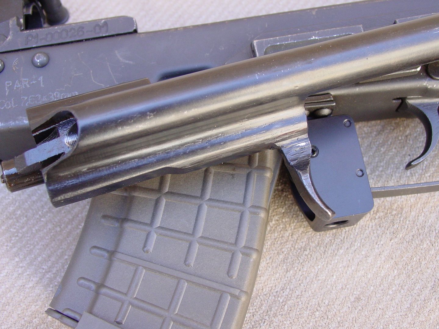

              I welded on this charging handle on my PAR-1 when I converted it to semi auto....
              The original carrier had no handle. I cut the handle off a destroyed carrier as a donor. Looks just like it came from the factory with it.
              If you want a permanent fix welding on a extension will solve your issue.
