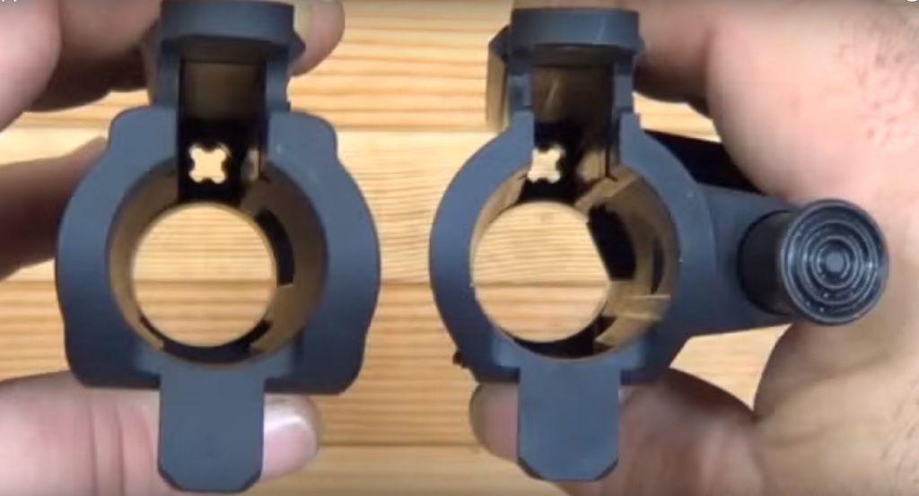

                I'm looking for a thicker than normal ar upper receiver. Heres a picture of something similar to what I'm talking about: The thin one on the right is an an example of an upper I do not want.

                              Most of what is advertised as light weight or thin is either the handguard or the barrel profile. The fat upper on left side of the picture looks like a DPMS slick side upper it's on their entry level models. The upper on the right is most likely a standard mil spec receiver
