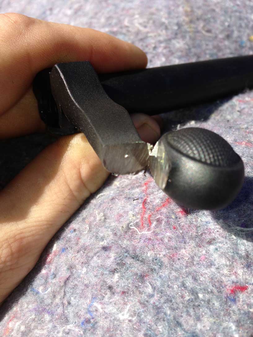

                    I do it that way because about 1/3 to 1/4 of them have a void in the casting.
                    By cutting off the old knob, I get rid of the void:
                    The people that cut threads on the existing metal that creates the knob will often end up with a void right in the area of the threads:
                    Voids like that leave a great place for the bolt handle to break off.

                      I found a void just like that on a buddies savage bolt handle when I was threading it. Filled it with TIG rod and started again, didn't seem to be a problem after that although the metal was harder to work with after.

                        I do these all the time for local Bay Area gun shops. I use a slightly different approach.
                        No welding, no factory void, plus a heat treated reinforcing screw at the bolt handle root joint, per Greg Tannel of Gre-Tan Rifles. Increasing the bolt arm up to 40% can add significant moment to the factory heat brazed joint. Back when I experimented with threading these in a lathe, I have had them tear off at the handle root due to tool pressure.
                        I am in Aptos, let me know if I can help.
                        Ken

                              Just thought it was interesting, cause you said "do it right" then proceeded to show a method that is considered a big no-no in the welding world. Welding to Cast isn't usually recommended because like you stated it is a very ferrous metal by nature and tends to have many voids, leading to cracks, especially at the edges of welds (or tacks, cant tell if that's MIG or TIG). Either way I highly doubt you have enough weld on that small surface area to get the cast to proper temps to create the proper bond.
                              I'm not doubting your process, and I'm sure you haven't had any problems. I've herd a lot of good stuff about your work! But I personally wouldn't consider that the "right" way to do a bolt knob job.
                              The threaded insert looks much more secure to me. Just my .02
