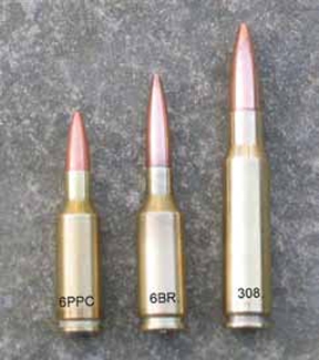

                              ar15barrels
                              • 57190
                              Originally posted by eighteenninetytwo
                              Is the 6.5 cartridge inherently more accurate than .223? or is it used by more accurate/ serious shooters generally and has a better reputation on that basis.
                              If you look at the most precise (accuracy and precision are different things) cartridges, they share a shorter and fatter powder column than typical military cartridges like 308/223.
                              6mm PPC and 6mm BR are the undisputed kings of shortrange and midrange benchrest cartridges.
                              If there were better cartridges for shooting small groups, benchrest shooters would use them and bencrest shooters are sticking with 6mm PPC and BR to this day.
                              Here are a bunch of the currently used mid-bore cartridges in the various precision rifle competition circuits:
                              The 6.5 Creedmoor is much more like one of those benchrest cartridges than it is like a 223.
                              If you want the best precision possible, go right to a 6mm BR or something closer to that design.
