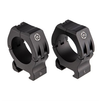

            Originally posted by DDRH
            I recommend Vortex Precision matches rings. Made by Seekins.
            30mm tube and .97" height should work. Don't go cheap on rings.
            If you can afford a little more check out American Rifle Company's rings.
            M10 rings:
            M-Brace rings:
            I prefer the ARC rings. Optics will not cant when torquing rings.
            M10 rings are the gold standard, but everything else named in this thread is a quality ring that won't let you down.
              I agree, simple one bolt for each ring. Also the optic doesn't cant when torquing to value. The Vortex/Seekins rings did this. Although, I'm sure I did something wrong haha.
              Also check out their newer M-Brace rings and Mount. It's a bit wider. Looks real nice!
