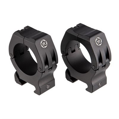

If you can afford a little more check out American Rifle Company's rings.

I prefer the ARC rings. Optics will not cant when torquing rings.Comment
