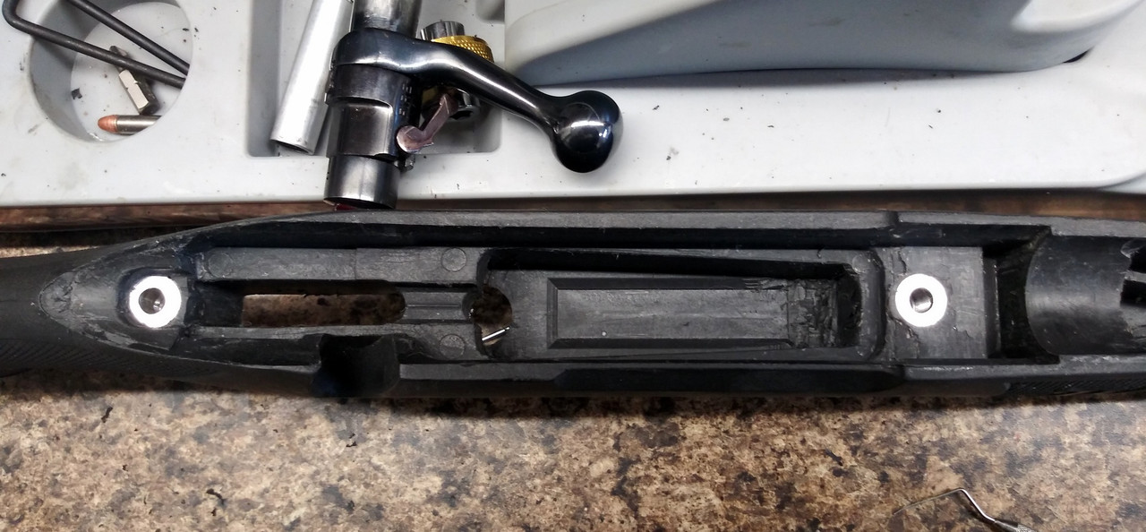

                          bigbossman
                          • 11298
                          Winchester model 70, pillar bedded with PC 7:
