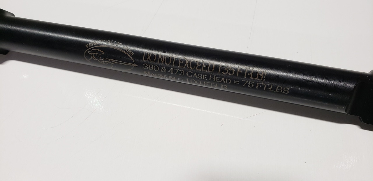

        Originally posted by fawndog
        I broke a action wrench on a T3.
        Was it one of the ones that slip inside the reciever and engage the lugs in order to turn the action?
        I only use those kind for installing barrels.
        I had to make my own set of heads for the Brownells action wrench system that holds the outside of the reciever for removing factory barrels.
        Good thing is that it's basically square with a little relief on one side for the lug area around the screw hole.
        Randall Rausch
        AR work: www.ar15barrels.com
          Yep, sheared off an ear on that wrench. Josh said he never heard of that.
            Some of those types of action wrenches are not heat treated so I could certainly understand them shearing off with the 250+ ft-lbs it takes to pull some Tikka barrels.
            Was yours one of these marked with the 135ft-lb limit?
            What do they tell people to do when 135 ft-lbs won't get the stock barrel loose?

              Definitely not, I have no clue. I sent him the action and bolt assembly just to check and make sure it was still straight.
