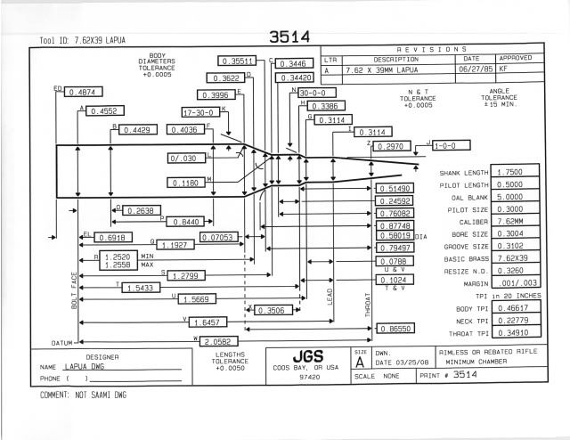

        I'm shooting 29 grains of aa2230 out of a .308 bore Kreiger in a mauser 98 action with 155 SMK Palma bullets seated out long.
        Kendog4570 built this gun for me, 18 moa 200-500 meters.
          kendog4570
          • 5180
          Listen up to 6mmintl. He has a PhD in 7.62X39. I used a .308 bore match barrel and JGD 7.62X39 Lapua reamer, per C.E Harris' writings. I can't remember the twist. It will handle .310's with no pressure problems, but accuracy is what you would expect with surplus ammo. Different story with good bullets and good reloading practices. He has shot more than a few 1/2 MOA groups with this gun. People cringe a little when he un-cases it at a 200 meter match. At full distance (500 M) he has no problem hitting the rams, but they don't always go down.

              I suppose that subject could get beat to death on a forum like this, but .308 to .311 is really no big deal. Tight bores don't significantly raise pressures. Tight necks are a sure way to raise them. One of the best ways to get a beat US 1917 shooting is to try Sierra match bullets for the .303 (.311) before you re barrel.

                          It's the Lapua chamber that makes the difference. The CIP chamber is for commie jungle fighting.
