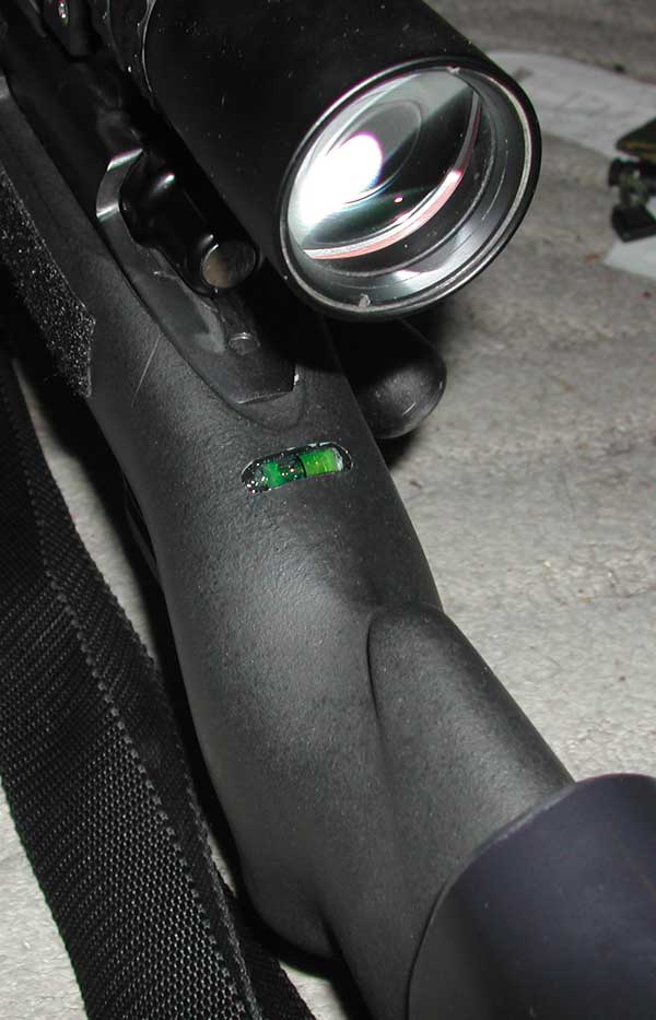

                        ar15barrels
                        • 57129
                        Originally posted by LynnJr
                        For whatever reason, I naturally cant my scope clockwise a couple degrees. This becomes a problem at longer ranges.
                        This is what I am talking about
                        Cut a slot in your stock and epoxy a level in it.
                        Make sure the gun is leveled and the bubble is centered while the epoxy cures.
                        It's important to be CONSISTENT in your cant.
                        The bubble will help you be consistently level.
                        Having the bubble in the stock allows you to use it without lifting off the stock.
                        The bubbles on top of the scope are almost useless because you have to lift your head off the gun to see them.
                        The act of lifting your head off and then getting a new cheekweld is enough to screw up your level.
                            I like the design of that level you did. Like you say, the silly bubble levers are kind of worthless because if you have time to look at the bubble, you have time to straighten the scope.
