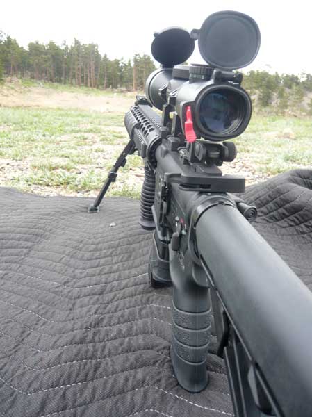

                              glock_this
                              • Dec 2005
                              • 8225
                              I have the GG&G (and a Harris and a polymer CAA) and it is by far my favorite of the 3. Very stout, very solid feeling and great quality and craftsmanship. No real excess material like the CAA. No ugly visible springs like the Harris. My first choice by far.
