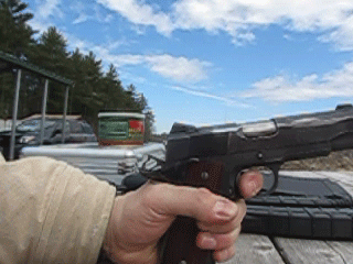

                  Brass kicked to the face by the slide is an ejection timing and/or ejection angle issue.
                  Factors that influence this are grip/wrist breaking, cartridge power to recoil spring weight, extractor tension and ejector length and nose angle among others, some of which have been noted by previous posters.
                  Some people think the cartridge is being directly ejected at their face, but in fact its the slide that's kicking the case backwards due to not clearing the ejection port in time as can be seen in this .gif of a 1911 doing it:
                  Now, before we continue I want to disclaim any personal experience with the remedies proposed below as it relates to M&P pistols; my experience is primarily with 1911's, HK's, HP's, etc. and I make no claims to any significant experience with M&P's. I'm merely relaying what I've read on the subject for you to consider.
                  Some people claim that leaving your magazine loaded for a week or two reduces the pressure it puts on the top cartridge in the magazine which may be "over supporting" the empty case during extraction thereby changing ejection angle.
                  Others claim that installing a 14lb Wolff Spring and Wolff recoil spring guide rod, both shortened by 3/4" for the 9c, has solved the problem for them. If you go with the Wolff setup your recoil spring will not be captive any longer which may or may not matter to you.
                  Apparently S&W may be slightly "over-springing" the 9mm versions by using the same 16 lb spring as used on the .40S&W and .357SIG variants.
                        Thanks for the GIF, I never thought that it could be the slide that kicked the brass backward.

                          Mine threw brass at me for the first couple of hundred rounds in exactly the manner the above GIF shows - I know that because of the brass mark on the lip of the ejection port. Now it doesn't happen at all.
