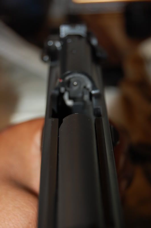

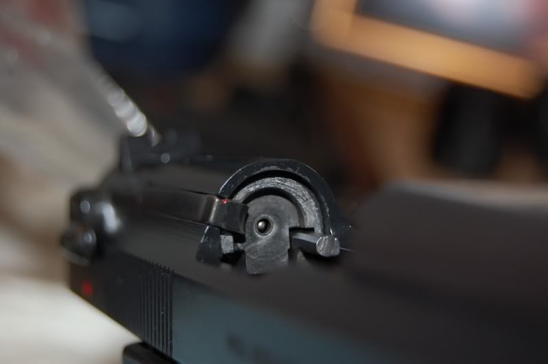

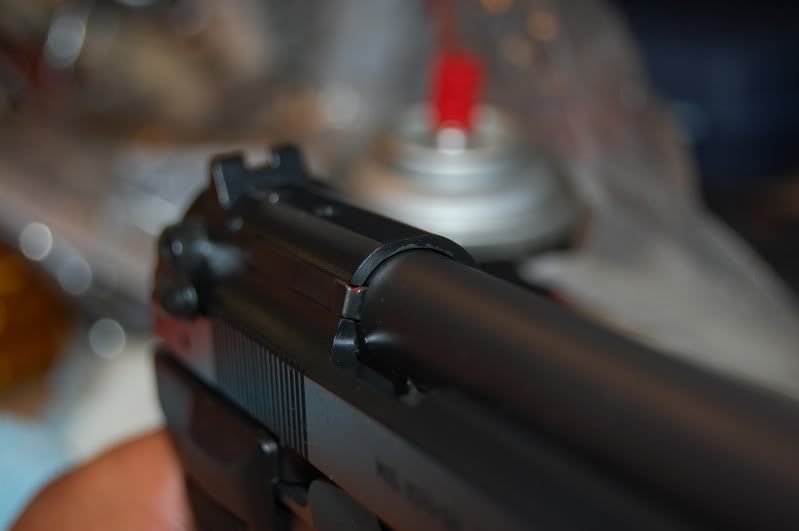

    so i've shot over 1k rounds so far since i've owned my m9a1. it's finally beginning to show the "used" look. however my barrel is peening with the slide. i'm pretty sure its not normal as it's a little sharp. it's obviously slamming hard. here's the pics:
    the wear is obvious on the top of the barrel
    just to show that the metal is peening upwards
    top of the slide where it's slamming
    normal?

    My 92fs does not have or do that ,maybe you could use a machinist file and just break the edge ,use a fine file. Just an ideas!

      I just looked at mine its the stainless steel version and it is showing a small shiny spot about where yours is but no burr.

        Mine has very slight signs of wear in those spots, not as nearly as severe, although mine was bought used in like new condition and has far fewer miles on it than yours. Have you had any malfunctions? Looks like maybe a lot of stovepipes or failures to eject.

                Your gun looks new. Inspect it regularly for cracks and stuff in the obvious places. When you fire a lot of rounds through an M9 type pistol the finish will actually come off of the barrel and it looks silver. Remember that the parts of the barrel that show on this pistol are not even visible on most other auto handguns.
                  smoothy8500
                  • 3846
                  As you put thousand(s) of rounds on a pistol you'll start seeing slight peening here and there. Dress the edges so they don't form cracks and keep an eye on it.

                    No peening on my 92FS
                    I have an Italian made 92FS (about 14 years old) and have many thousands of rounds through mine with no peening (or even shiney areas) on the chamber end of the barrel with the exception of a very small shiney edge just at the slot for the extractor, no burrs though.

                      I've not yet fired that many rounds off my 92fs yet, and though I've seen range rental guns with similar wear, I would expect to see that level of erosion on a gun with more round counts. Are you using stock factory recoil springs? Do you close the slide using the slide release on a empty chamber often? What kind of diet has she been fed?

                        Normal wear. Gun looks brand new. If it still works dont worry. If it is a big deal to you take it to a gunsmith. If anything its been there for a while though you just noticed it.

                          ya the gun is totally stock minus the x300. i saw the peening after the first initial 200rds. and as i continued to shoot it over the 1k mark, the peening is progressively getting worst. maybe once i file the burs down, it should be good to go.
                          and to the people that say my gun looks new... it is. it's only 2 months old. i handload ammo and have thousands at my disposal ($4.50 per 50rds per the reloading calculator). of course it wouldn't have wear on the exterior (as it isn't a carry gun), but the interior is definitely showing it's round count. my gun is definitely going through the ringer. i'll be running it for USPSA on my next match.

                            Check your locking lugs and make sure they aren't wearing funny and something isn't lining up right. I've got a 92f with 20+ thousand rounds thru it that doesn't show that much wear.
                            You mentioned handloads. Are you running real hot loads?
                            I'd have it checked by a Beretta certified armorer.
