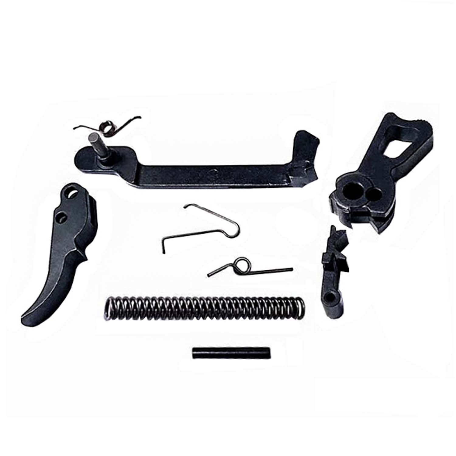

        More info.......The new Xtreme trigger is a no go shape for many.
        You can build what you want, factory or LTT

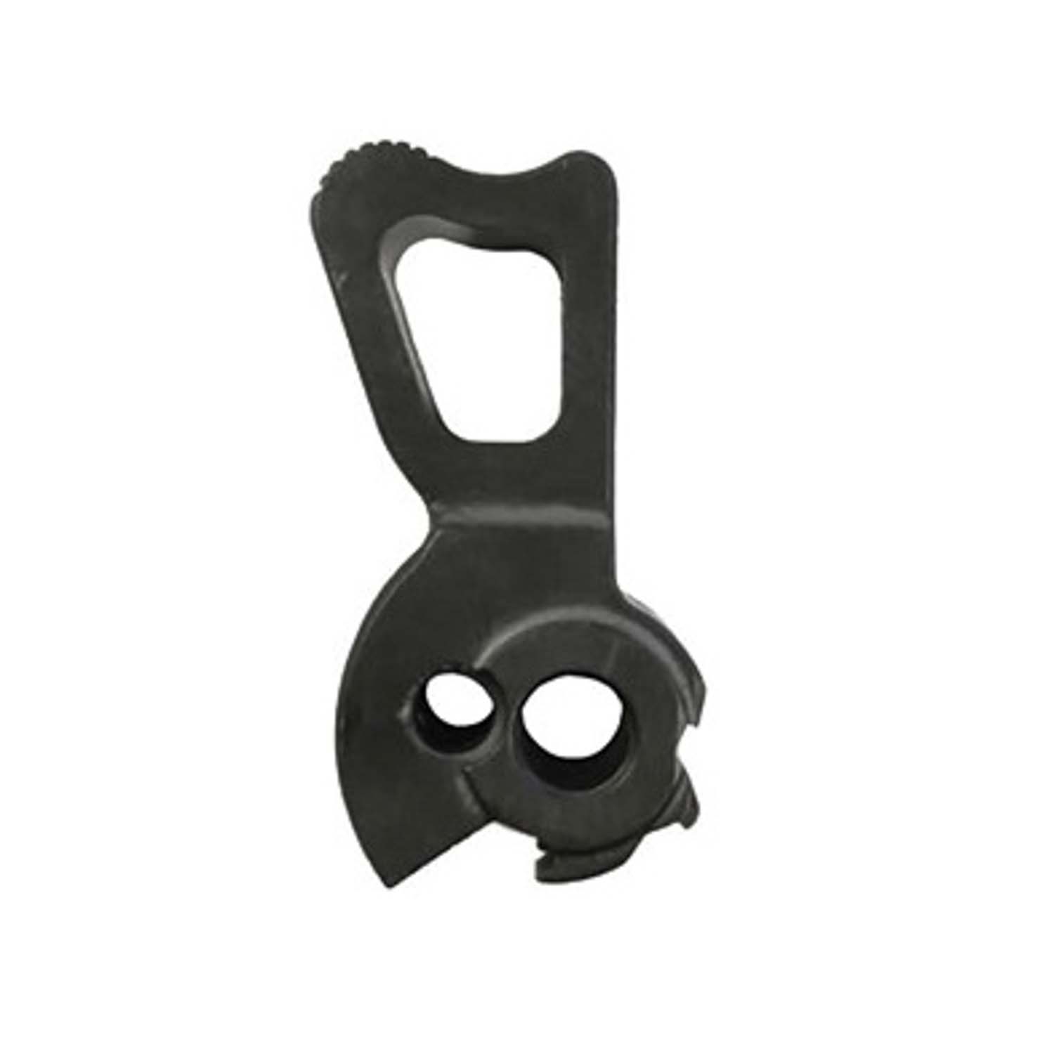

        Check out the deal on Beretta Xtreme-S 92x Performance Fire Control Group at MGW
        Check out the deal on Beretta 92X Performance Trigger Bar at MGW
        Check out the deal on Beretta 92 Series Match Hammer, Skeletonized at MGW

                The 92X Performance trigger is supposed to give you a flat trigger when in SA, but I found the DA reach was a bit long.
                On my 92X Performance I installed the WC short reach trigger, I like it much better in both SA & DA. The only change is the reach to the trigger, there's no performance enhancement I could discern.
                The 12 lb hammer spring reduced the pull weight considerably in my Brigadier.
                The LTT Optimized trigger bar also made a huge difference in my Brigadier. Considerably shortened the trigger reset in SA.
                I tried the WC trigger bar, to me it seemed to make the DA trigger stroke longer, which was not helpful.
                Beretta also makes a Match Hammer, I haven't installed this on my Brigadier only because I can't find one in stock, which is supposed to eliminate a lot of the remaining pretravel in SA. Has to be used with either the Beretta Extreme X trigger bar or the LTT optimized performance trigger bar to work properly, according to Ernest Langdon.

                              Yea a classic upgrade set is: #12-13 hammer spring, LLT trigger bar, Wilson SR trigger, and thin g10 grips. And G decocker since a dead trigger sucks. Makes it rip.
