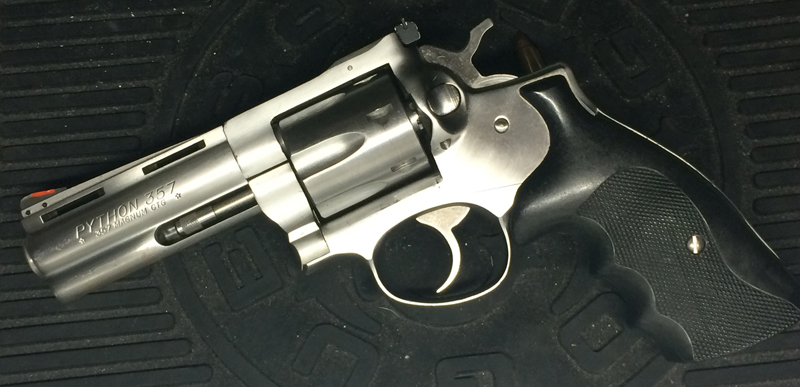

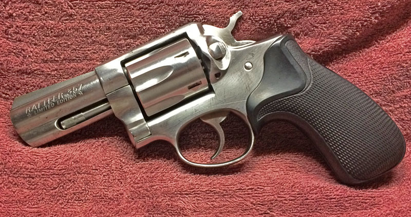

    That's cool. I have a bright blued 28 (factory refinish) that I've been thinking of converting. Just curious, how does the barrel rib/frame junction look at the top? Did the rear sight have to be extended to mate to the rib?
    May as well as some pics of prior and current Smolts/Cougers:

      Looks fine to my eye.
      It wasn't extended and doesn't appear to have any gross lines or gaps.
      Added pics.
