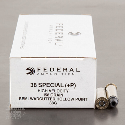

      I tested all the recommended .38 special self defense ammo (Gold Dot, Critical Defense, Hydra-Shok, etc.) in a Ruger LCR. The only ammo that expanded in a pig carcass was this one. I didn't use denim in my tests.
      Federal 38 Special ammo for sale at AmmoToGo.com - Don't miss these 50 round packs of 158 Grain Lead Semi-Wadcutter Hollow Point(LSWCHP) ammunition in-stock now.
