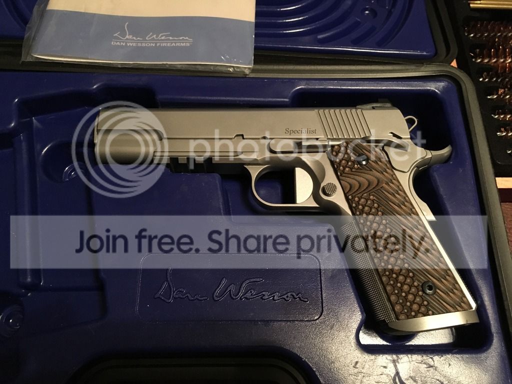

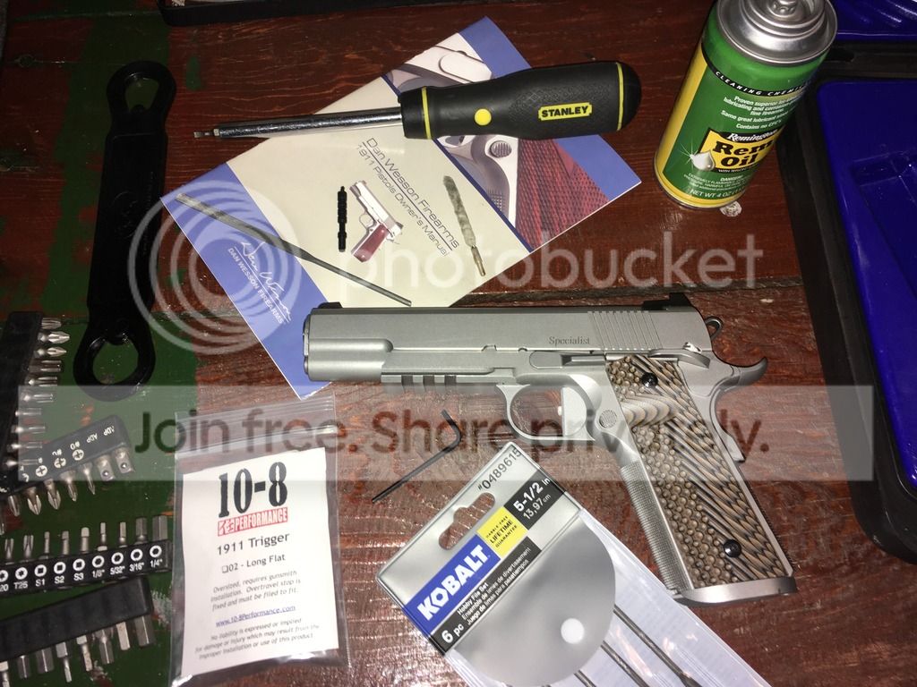

    I have loved flat triggers on 1911s since I shot a buddies sig scorpion 3-4 years ago. I'd bought a 10-8 performance trigger about a year ago but had never tried to do anything with it. Well that changed the other night when I got a wild hair and decided to do my own gunsmithing. Bought some files and took my time and got the trigger in perfect!
    Probably should have tried this on my rock island first instead of going straight to the Dan Wesson! Oh well

                Do you have a trigger bow tool? Make sure the mag still drops free.

                  Had to file the top and bottom of the actual trigger cause it was too tall to fit initially. Once I got it to fit there was just the tiniest, tiniest amount of play up and down the same as the trigger that came with it. Then I had to file down the overtravel stop as it comes fixed on this trigger. Took me probably an hour and a half to get it exactly how I wanted it. I kept putting everything back together to check tolerances at least 8-10 times.

                          The jig for the bow helps if you have drag on it when inserting a mag.
                          With just the bow installed and no mag catch, slide the mag in with the frame laying flat. If the shoe moves when sliding in the mag it means it may drag on the mag when pressing rearward.
                          Check both sides of the bow by laying the frame on the other side.
                          If it contacts, be super careful tweaking the bow. This is where the jig helps.
                          Check out how to notch your forward edge of the bow and create your own pre travel adjustment nub. This works very well if you have loads of excessive trigger movement.
                          Don't get me started on working the disco, flatspring, sear.......
