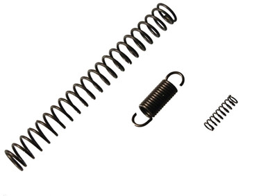

                I have not had good luck with aftermarket connectors, I only use factory minus connectors. I would also polish the minus connector, the firing pin safety plunger, and the trigger bar where it interfaces with the connector and the safety plunger, and the tab on the trigger bar that engages the striker, and if you want the face of the foot on the striker.
                You can also add an extra power trigger spring and a reduced power safety plunger spring - less than $10 for both. That will get you closer to where you want. If you want to go any lower, you will need to use a reduced power striker spring.
                I would just order this spring kit from Wolff so you have everything you need, and only use the striker spring from the kit if you still feel you need a lower pull. I personally would not use the light striker spring for defensive purposes.
                Enhance your Glock with the Wolff Competition Spring Kit. Smoother, lighter trigger pull for Gen 1-4. Ideal for competition. Ships fast from NDZ Performance.
                NDZ also sells factory Glock minus connectors for a good price.
                Shop premium Glock parts & accessories for Gen 1–6. From slide upgrades to internal components, boost performance & reliability. Trusted by firearm enthusiasts.
                WITH FREE SHIP OVER $20 - it is a no-brainer: one stop shopping for connector and comp spring set - only $26.50 out the door. I have ordered a bunch of factory connectors from NDZ over the years.
