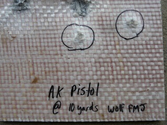

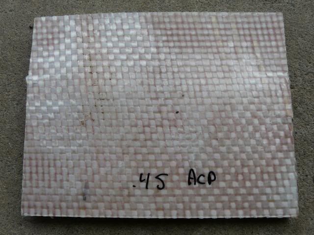

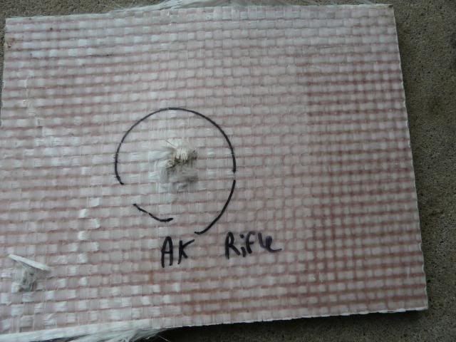

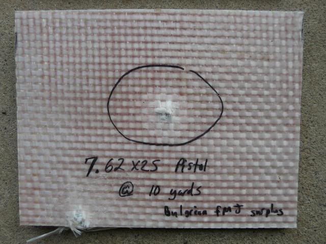

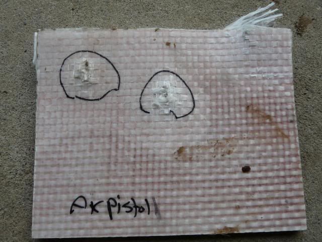

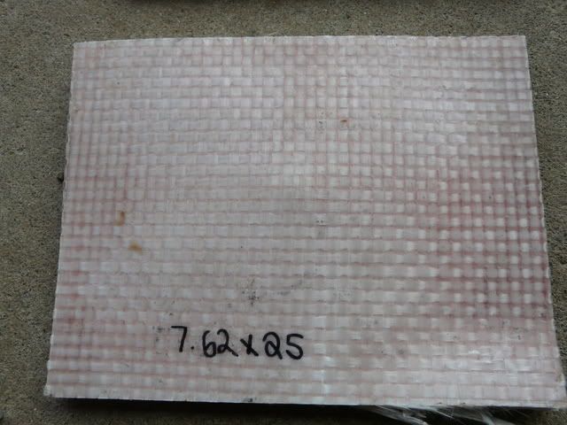

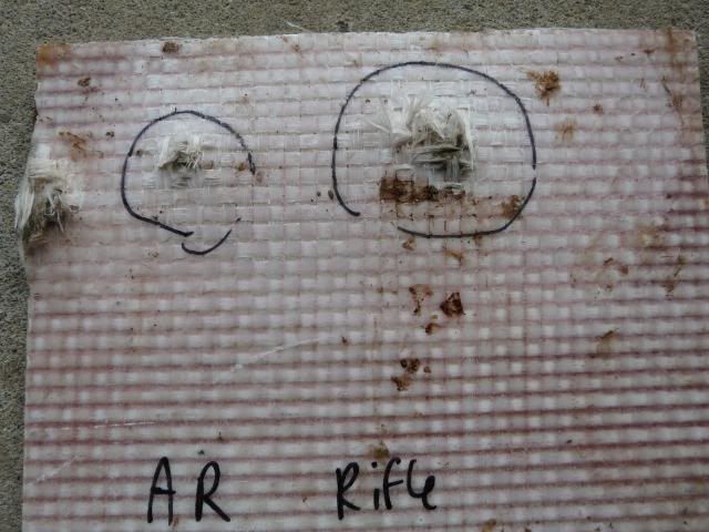

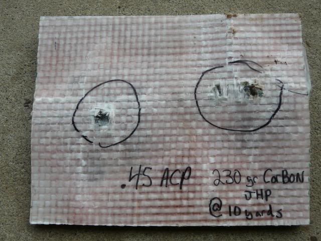

    I took a trip up to the hills today and thought I'd bring along some scraps of Bullet-Board from work to test out. This stuff is some sort of Kevlar/fiberglass laminate about half an inch thick. We use this stuff to line rooms where one might fear gunfire like courtroom walls, certain rooms in hospitals, etc. I was told it would stand up to a .357 mag, I don't have one of those so I tried a couple of other things.
    My .45 wouldn't go through with the +P Corbons ( now I'm not sure of the weight of the bullets since I've had them in a mag for a few years but I think they were 230s) I had which is what I expected but was surprised when my CZ-52 wouldn't either after I had heard all the stories of it's armor penetrating abilities.

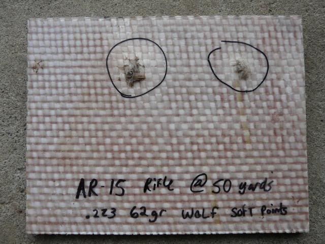

    My AR and AK rifles easily penetrated the barrier but that was to be expected since the board is primarily designed to resist pistols. I did have to throw a monkeywrench into that logic by using a rifle calibered pistol to defeat the barrier. The AK pistol went right through.

    AK rifle
    AK pistol

                          A 4x8 sheet weighs about 125 pounds, I'm sure with enough layers it would stop rifle rounds but who knows how many layers it would take? The only multi-sheet test we did was with a Mosin M44 and just slapped 4 layers tight together in the snow, it went through.
