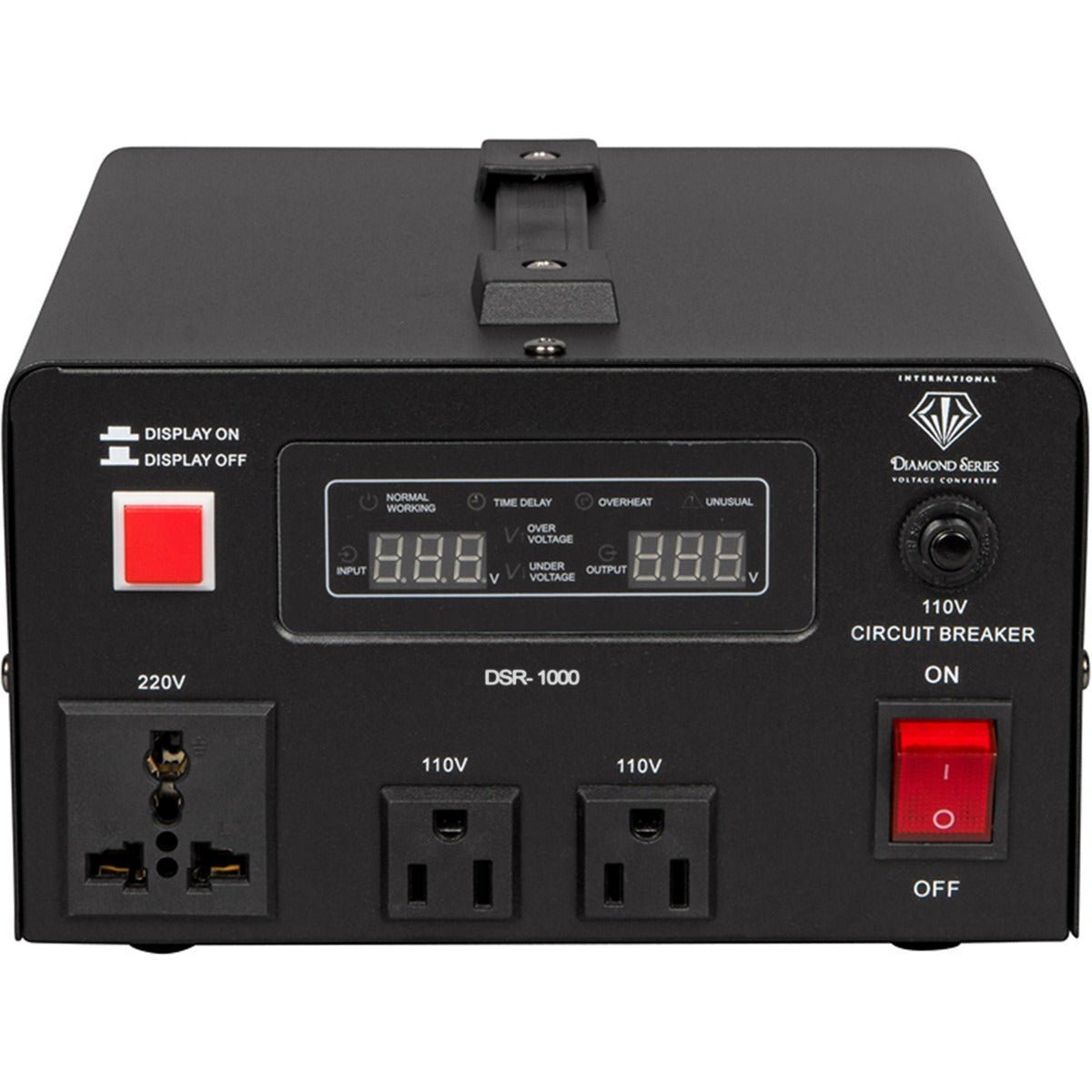

      Here's one site, pending the info about wattage:
      Buy Diamond Series Type 5 step up & down voltage stabilizers. Diamond Series transformers, CE approved, 5-year warranty on Type 5. Worldwide shipping.
      I'm not sure what they charge for shipping though.
