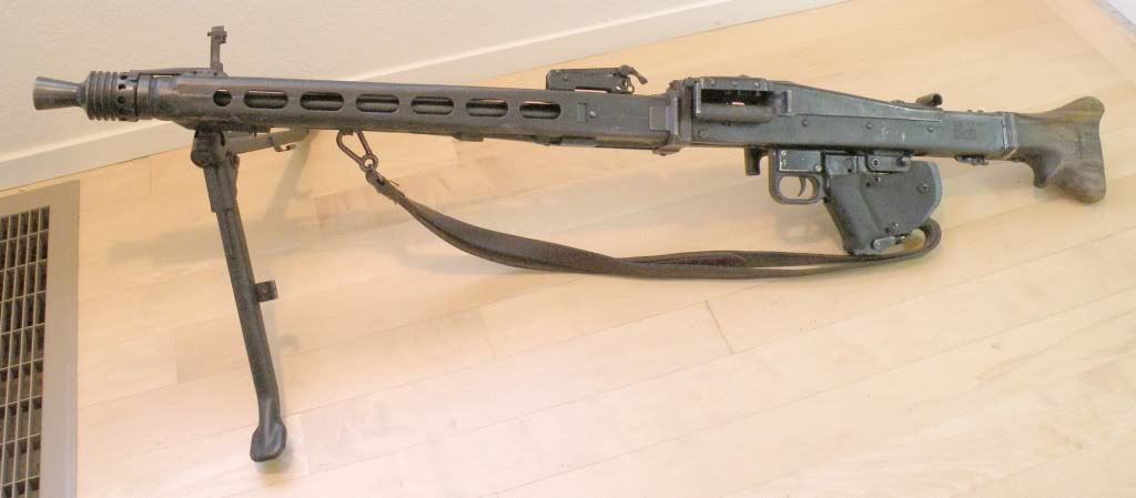

                    First of all: 50 round belts. You needed to own them before January 1 2000 for them to be legal to use in CA.
                    The Henderson Defense option is one way to go, but, because it has a bullet button, you are limited to 10 round belts. I doubt that Henderson is doing those mods any more because Wise Lite is no longer making M53s.
                    Assuming you already own legal belts, the best way to import into CA is as a receiver (only) to your FFL. Have the seller send you the other parts separately, directly to your home. Then you need to make two mods to make it a featureless rifle BEFORE reassembly.
                    1) The trigger group/grip goes to Solar Tactical for a grip fin, making it no longer a pistol grip.

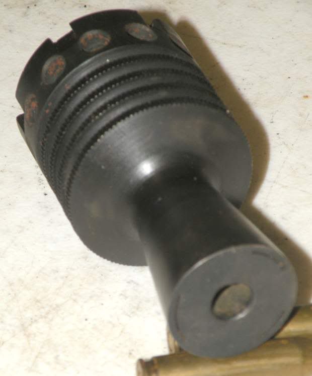

                    2) The other project is eliminating the flash hider as an evil feature. I had a piece machined that was welded into the flash hider (pics below). A easier solution is to weld a washer with a 10mm hole into the end of the flash hider.
                    Flash hider with filler part welded into place:
                    Final results: a legal CA featureless rifle with grip fin and modified flash hider:

                      I have a mg 34 being built and would love to get info on your booster cone mod.
                        timdps
                        • Feb 2007
                        • 3445
                        Here are a couple of photos of the cone:
                        Store your photos and videos online with secure storage from Photobucket. Available on iOS, Android and desktop. Securely backup your memories and sign up today!
                        At this point I would probably find a washer that fits just inside the flash hider cone and has a hole about 10mm in diameter and weld it in.

                            I was wondering about the Booster, because the flash hider also acts as a 'gas pressure accumulator' and assists in the functioning of the gun, the fact that it MAY affect any muzzle flash is secondary..... I mean look at it, the hole is just a bit larger than the bore plus the barrel/booster bushing sits inside it and is a 'gas piston' of a sort.... the gun is quite an ingeious piecec of functionality actually,, that is why they are totally reliable in original form... semi auto with converted/non std parts,well.......
                            I am definitley going to hit up TNW on the Approval letter question.
                            Otherwise a welded in washer and gripwrap huh...hmmm......possible and running a 50 round belt in a drum is great...
