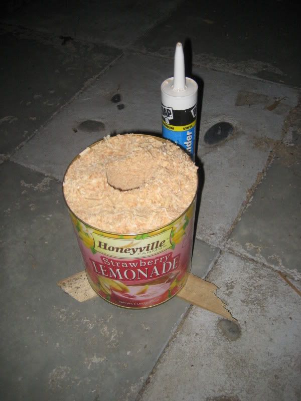

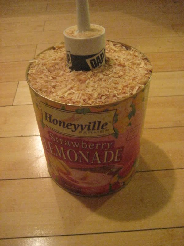

    Here is the sawdust packed into a #10 can. I drilled a 1.5" or so hole in the bottom, placed inside a tube of caulking that was laying around, packed it full of sawdust and compressed it as tight as I could.

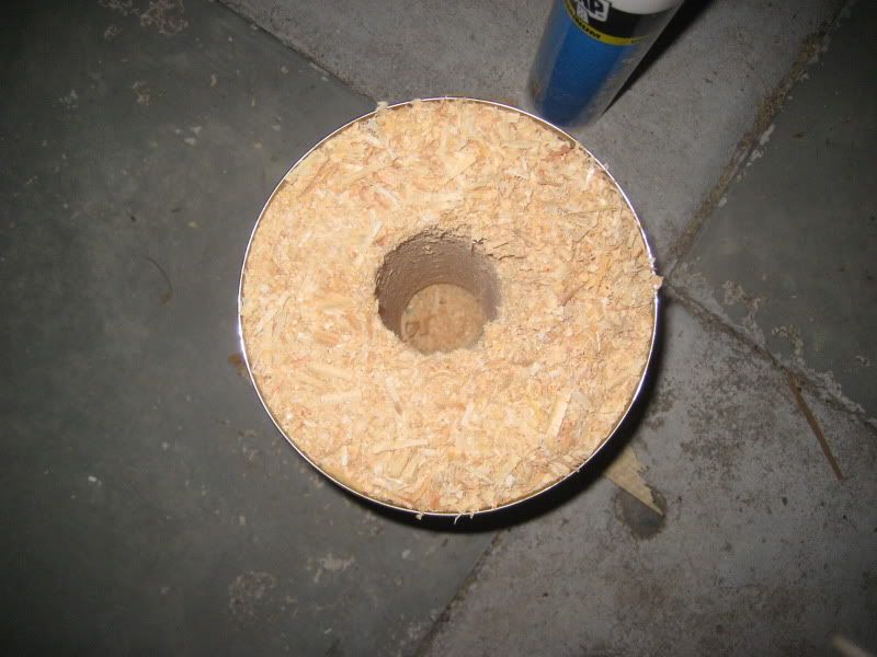

    Then I removed the caulking tube:
    inside:

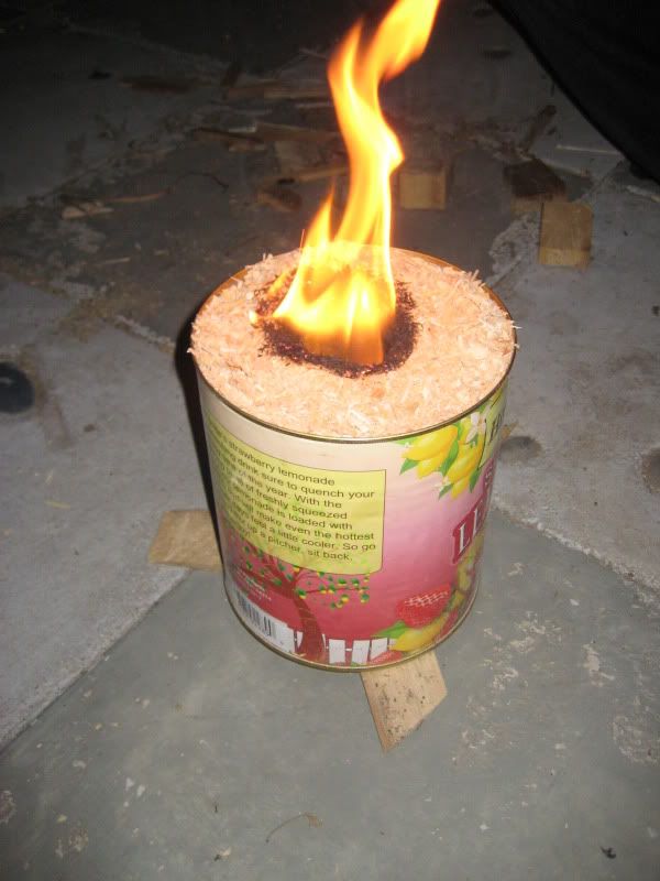

    I lit a piece of paper and shoved it a few inches into the top. Within a few seconds it took off and started burning the whole length of the hole. Its important to prop up the can(i used wood wedges I had laying around). This allows the air to come through the bottom so it can burn. this is what makes it work.

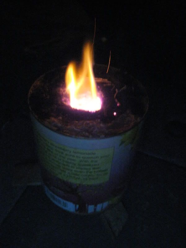

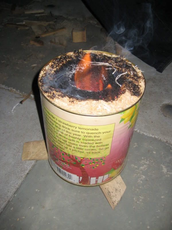

    Within a few minutes it settled down a bit
    If done right, these can burn all night long.
    Right now its just glowing inside producing plenty of heat and virtually no smoke. I could cook on it easily. Mine was made with some pretty coarse sawdust from a router, so I think its burning faster than finer sawdust might have. Its also pretty tall because its a #10 can as opposed to a paint can. Apparently the taller the stove, the hotter it burns and the fatter it is, the longer it burns. Its been burning about an hour and a half and the stove has burned maybe 40-50% of the sawdust so far. Since I produce about 100 gallons of sawdust a week, I definitely have enough if I wanted to store it and use for emergency heat or for a campfire replacement on camping trips.
    I'm going to let it burn out and see how long it lasts. You can add a can on top with a hole cut in it to turn it into a makeshift wood stove that will radiate heat. If you build a chimney in it, it can be burned in an enclosed space(atop something metal) and direct the smoke outside. With some experimenting, I might be able to burn the smoke too like a woodgas stove to produce even more heat and eliminate the smoke.

                          Only about 2.5 hours. I'm going to try some finer sawdust and see if that makes it last longer.

                          how did you compress the sawdust? Hammer and stick? Or something more like a hydraulic jack or press?
                          just with a stick.
