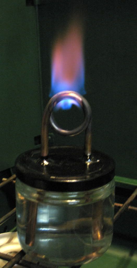

                Here is the coil jet in action. Took about 30 minutes to build. I used 1/4" copper piping filled with sand and plugged it, before bending the coil, to prevent the pipe from crushing and folding on itself. I soldered the pipes to the lid of a salsa jar. The jet hole is tiny, and there are small drain holes on each of the pipes just under the lid to prevent the alcohol being sucked up into the pipe and spraying out of the jet. I made two wicks from a M16 cotton pipe cleaner wrapped tightly with cotton wool, but I think I will change it out to two fiber glass 1/4" lamp wicks soon. It has to be primed, so I just put a small drop of Heet in a beer bottle cap under the coil to heat it and this will ignite the jet.
                Next one I build, I am going with 3/8" copper pipe, a squatter jar and to fix the coil lower towards the lid (just enough space to slide a flaming beer bottle cap) just to reduce the distance the alcohol has to travel up the wick, as I think this will make it more efficient and produce a fiercer jet flame.
