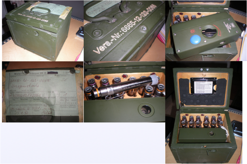

    Anyone have more information in this:
    I found some general information in Wikipedia which I found useful. I am not sure where you charge the tube though. I think I stick the capped end onto the the blue button and depress it with that end.
    Pressing on the blue button and/or turning the rheostat does not make the inspection bulb (I think) illuminate so I'm not sure the box works or not. The filament of the bulb looks to be intact but I have not done a continuity teat on it yet. The unit takes 2 D cells.
    When I look through the tube I can see gradations but I am not sure what scale they are.
    This was an impulse purchase from a while back that was just one of those cool gadgets from the Cold War to catch my eye. I never thought that I'd actually might have a reason to use it though.

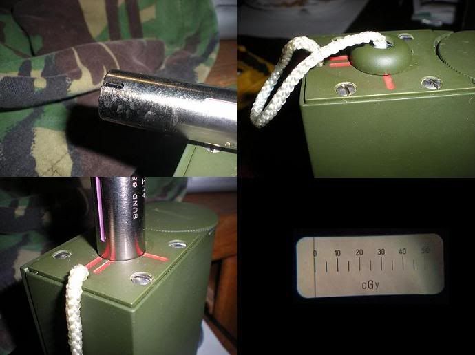

            So I checked this thing out some more and figured out how to charge it. There's a dust cover on the side of the unit that pops off. You remove the dust cap from the dosimeter tube and insert it into the hole, lining the slot on the tip of the dosimeter tube with the stud on the inside of the hole. Once you do this the light turns on and you use the rheostat thing to zero out the dosimeter.
            The unit of measure is cGy or "centigray". 1 centigray = 1 rad.
            I charged them up to see if they hold a charge. If they don't then I'm either being irradiated or these things don't hold a charge.
            If they do hold a charge I'll take them out Friday to see how much of a dose I get.
