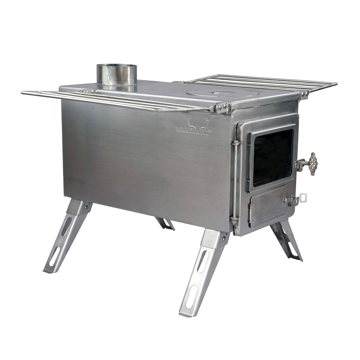

    I use a Winnerwell Woodlander large, no side-glass panels, in a bell tent. It has a glass window on door. From what I've read, glass panels can increase heating transfer/output of the stove. I opted for no glass, and the stove puts out more than enough heat for me.
    The pipe exit is through the roof with the provided heat-resistant panel and cover. If the cover is rolled correctly above the pipe exit, water will flow around it. I use a triple wall pipe section to go through the tent panel. Winnerwell sells a flashing kit that makes the pipe exit watertight, but I don't use it.
    I use smoke and CO detectors when running the stove. If there is creosote buildup (especially on spark arrestor), smoke/fumes can back up into the tent.
    For more circulation of heated air in tent, you can also use heat-driven fans that are placed on the stove to move air around.
    I looked at Winnerwell and Pomoly for stoves, both seem to be good established brands.

        My friend has a Bell tent and uses the Winnerwell Nomad large.
        He's quite happy with it.
        Deep enough to accept standard size split firewood while remaining portable enough to travel well, the Winnerwell Nomad Large is a rugged and versatile 304 stainless steel wood burning stove. Ideal for use in stove compatible tents and shelters and as a cook stove in the open.
