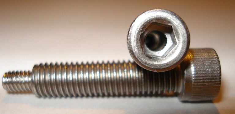

                  A 60 cent alternative would be to swing by Lowes or Home Depot and buy this;
                  It requires you take your grip off to adjust, but basically once it's set you really don't need to mess with it anyhow.

                    Ill second 9mm1911's comments.. I have done that to not only my 4 AR's but several friends AR's and the difference is huge... Some lowers may need to have the threading finished (some dont go all the way through) but that is easily done with a tap from your local hardware store.. Its one of those mods that you just set and forget, although I do highly recommend the use of lock-tight once you get the set screw adjusted. You can take it a step further and bob your hammer and install JP low power springs and drop the trigger pull to a very nice 4lbs with almost or no creep and a nice crisp break. Im not saying this is as good as a Timney trigger, but for less than $15 in parts and a little elbow grease it is damn near as nice... I know that at this point I would never spend the $200+ on a trigger when I can get almost the same result for $15!! On a side note I have fired over 1000 rounds of Lake City XM193 and not a single light primer strike (I figured that someone would comment about that being a possibility with the light springs)

                          Seems like this mod would defeat the purpose of a 2 stage trigger. Essentially, the screw pulls the trigger back 99% of the way, so that you only have to move it that last little bit to get it to fire.
                          Moreover, with the method I mentioned you may have to file down a bit of the trigger to avoid interference with the safety. I've got no problem messing around with a trigger that I could easily replace for a few dollars, but you might not want to do that with a custom trigger that likely cost you $100 or more.
                          Originally posted by makav3li
                          are there any issues with the screw for the grip?
                          It's possible. I've done this on 2 of my AR's and one of my friends. All had PSA LPK's, but one of them had a slightly longer grip screw that did interfere. Just trimmed down the screw a bit and problem was solved. Basically, YMMV.

                            These trigger adjusters are found on higher end lowers - look at a franklin or seekins- they are built in.
                            I have this function from my cnc80 lower, now i wont run a long range AR without one. For a CQB type rifle, maybe not so much.
                            Sooooo nice. I tried the short nut from Home depot but i almost requires you to mill out a half moon from the rear of the trigger so it doesnt interfere with the selector.
                            Pair this with the wolff 3.5# spring and its as close to a high dollar custom trigger as you can get.
                            as for negligent discharges, yes Its possible if you overadjust it that it might ND or FA on you, so be careful how much adjustment you give it. I back mine out 1/3-1/2 turn and have had no issues with mine.
