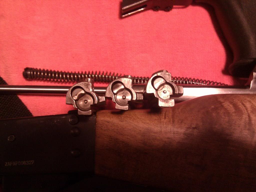

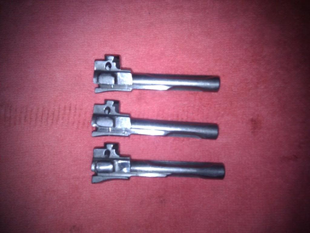

                    can you post a pic of the bolt that came with yours?... now I'm curious if Century has used different bolts... I haven't heard that anywhere.
                    Here are some crappy cell pics of mine to show the differences (and lack of)
                    first bolt is EAA Zastava PAP (the single stack), second bolt is the CIA Zastava PAP (the double stack) and the third is a standard Yugo bolt...
                    both the Zastava bolts are the same (because both rifles come from the factory as single stack)... century modified the mag well but didn't replace with standard bolt.
                    The single stack bolt occasionally has problems picking up rounds in a double stack mag. From everything I've read (which is a bunch from a lot of different forums) it is definitely intermittent between guns - which I attribute to poor quality control from Century.,

                      Thank you LBDamned for posting those pictures. I am more than curious now to see if the PAP I ordered a few days ago will have any changes to the bolt or magwell from yours. When i get mine in i will take some pictures of the bolt and magwell and compare with you guys. Atlantic seems to say that they got a whole new shipment in from a different dealer and they had to pay what they had to pay to get them, trying to justify the 950.00 price tag i believe.
