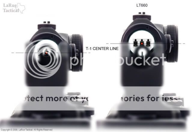

        The long explanation is, it's really all about reducing clutter, and always being ready.

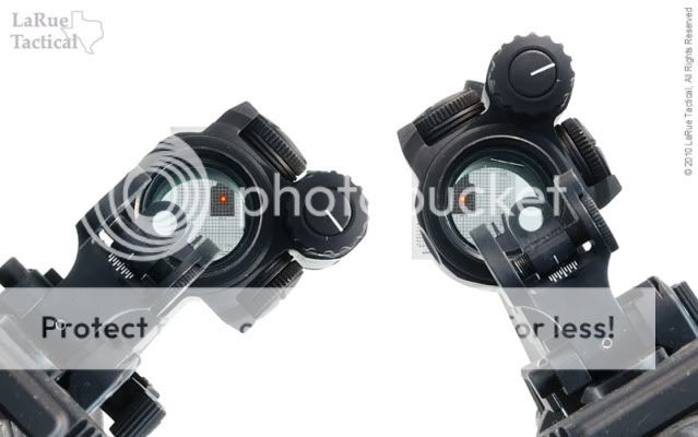

        Our Aimpoint and EOTech mounts are optimally designed for weapon systems that run with fixed sights or BUIS's deployed in the upright position. Since it takes time to deploy flip-up irons, we here at LaRue (and many instructors) recommend you operate with the irons upright when possible. Chances are, if you actually need your irons, you're getting pretty busy, with at least one threat occupying your attention. Keeping them up, but out of the way, is the best of both worlds. Our lower-1/3 design keeps those irons out of the way, until they are needed.
        Clutter in you field of view (FOV) isn't a good thing...with respect to the popular T1 micro, an upright rear sight can optically cover roughly 50% of the FOV. You can cover the front of an Aimpoint all you want, and still use the sight (keeping both eyes open), but covering the rear obstructs both target and reticle. (see the pic below).
