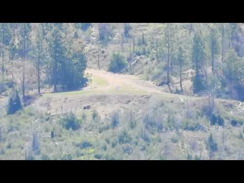

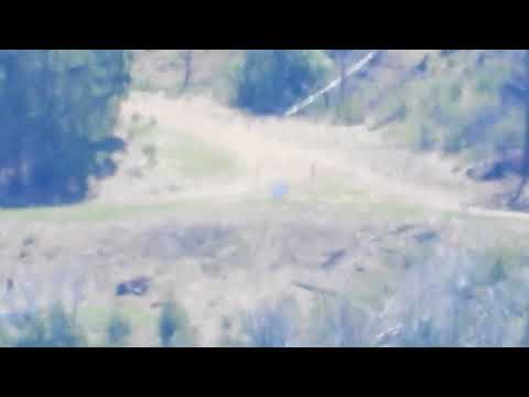

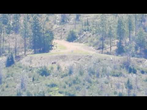

    A few weeks ago, Lynn invited me to shoot the 3300 yard target they'd set up for URSA matches. We spent a couple hours waiting for fog to clear at the shooting position but eventually gave up. We were going to try again Wednesday, but something came up and he couldn't make it. I went up on my own to give it a try.
    The target is the light spot between the big rock and the camera. It's 37" in diameter, a little over 1moa or 0.3 mil at that distance.
    I shot six strings of 10 and captured video on 3 of them. There are 2 hits in each video. After looking at the target, 1 hit is a skip for sure and a second probably is. These are raw shooting video and I could have done a better job setting the camera up for less shaking. No narration, no pretty girls, just spotting video that probably would have been better if there had really been a spotter. Lynn likes Video 3 the most. It's the shakiest, lowest contrast, and mirage is starting but my shooting was probably the best and most of the splashes were very visible.
    The gun is a RPR with a 30" 1:8 Bartein barrel chambered in 300 Lapua shooting 250 grain ATips at 2950 fps. The scope is a 7-35 ATACR on the 30 moa Ruger base in Burris rings with 20 moa inserts. I used a 30 mil NF wedge in front of the scope. The firing solution was ~ 50 mils. The windage turret had left 4 mils in it to cover spin, Coriolis, and to center the wind in the relatively narrow field of view. Wind holds were between 1 mil right and 2 mils left. Time of flight is 7 seconds.

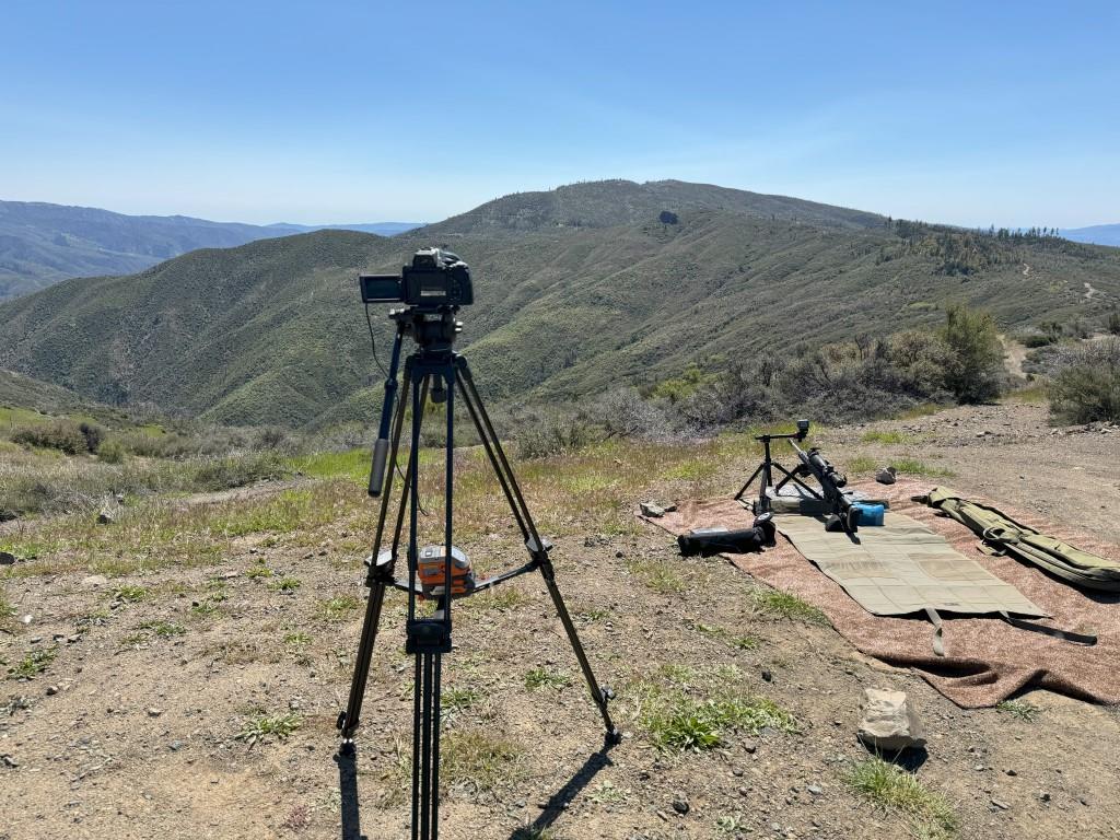

              Tell me about the camera setup!

                    I was introduced to that camera setup by RickyRacer87 at a URSA match.
                    It's a Nikon P1000 on an Amazon knock off surveyor's tripod with a video head. I'm powering it from an inverter on a cordless drill battery. These videos were recorded in the camera itself. I set it up for self spotting with a video to WiFi adapter and set my cell phone up on a bag on the left side of the gun. I was getting enough feedback through the rifle scope this day that I didn't set that up. The WiFi adapter software allows recording on the phone. I'll power the phone from the cordless drill battery when I'm spotting with it. I don't usually extend the tripod legs and often use a 25# weight on the spider between the legs. The camera is nose heavy for a standard 1/4"-20 camera mount. RR87 has a better tripod mount system. Maybe he'll post that.
                    I fought the idea of spotting with the camera for years because I didn't want to lose the reticle. I think the reticle speeds things up when there is a spotter that needs to communicate with the shooter but I don't miss it at all for self spotting. The latency on this system is very low so it might not be the way to go for self spotting on closer targets.
                    It has a lot more resolution than my Swaro 60X spotter. If you're familiar with digital photography, it'll pull images out of deeper darkness or can produce more contrast on bright blown out days. If you know what you're doing, it's a lot more flexible than lower cost spotting scope mounted cameras. It's complicated enough that dry firing it several times at home is a good idea before you bring it to the range.
                    This is the WiFi adapter
                    The US versions of the camera can be a little bit of a pain to find at MSRP from reputable suppliers. Heavily marked up US versions and gray units from other markets are easier to find.
