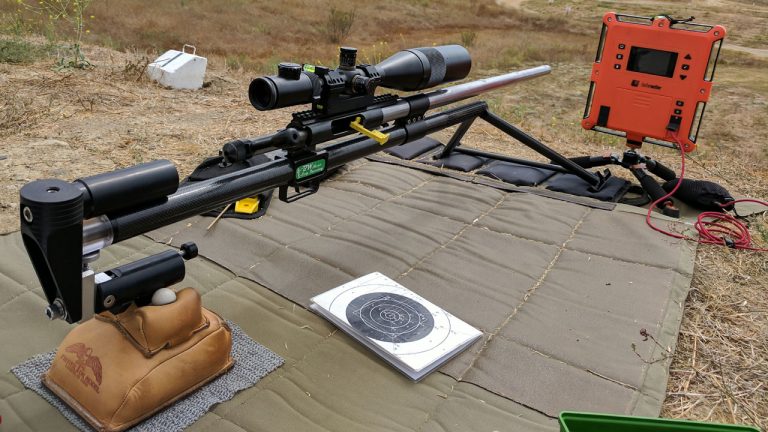

                      I saw this pic of a weird rifle on their website, what the heck is that?
                      [IMG][/IMG]
                      That is Simmons rifle. It started as a Rem 700 308 and he installed a new action on it. It’s a carbon fiber tube frame that he made and it’s supported by a carbon fiber bipod that he also made. Simmon routinely shoots in the high 180’s to the low 190’s. IIRC. He has shot above 195 more than a few times and shot a few cleans, The reason behind the odd stock is to save weight. His barrel is heavy and he is right at the weight limit. That picture was taken at Twentynine Palms I believe last november due to the clear picture. They shut down the 2016 match do to wind, so much sand locked up a few guns and your could not see the targets.
