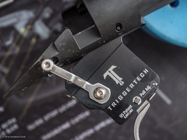

            ocabj
            • 7924
            TriggerTech.
