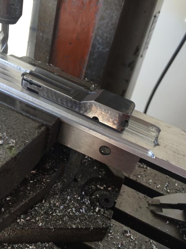

            Well I'm a beginner machinist at best. I am a fabricator, welder, welding inspector and instructor so I got a little bit of measuring experience lol. I came across a bolt together receiver on maybe weaponeer, can't remember. I'm just trying to think outside the box and make some chips. The bolt together one that I'm adapting to a weld together unit. It's composed of side plates, top plate and front and rear trunions. I started on the top plate already. I plan to leave the aluminum welds in tact because I'm fairly good with aluminum welding. The whole idea got me thinking of the ak style with rivets in maybe a charger form.
            All of it will be done using my new "to me" mini column I just picked up.its an old tai unit from the 70's. I'll be adding some DRO units shortly. Adding tooling as I go
            Starting the top plate
            Machining the stuff oversize and I'll cut to final dimensions later

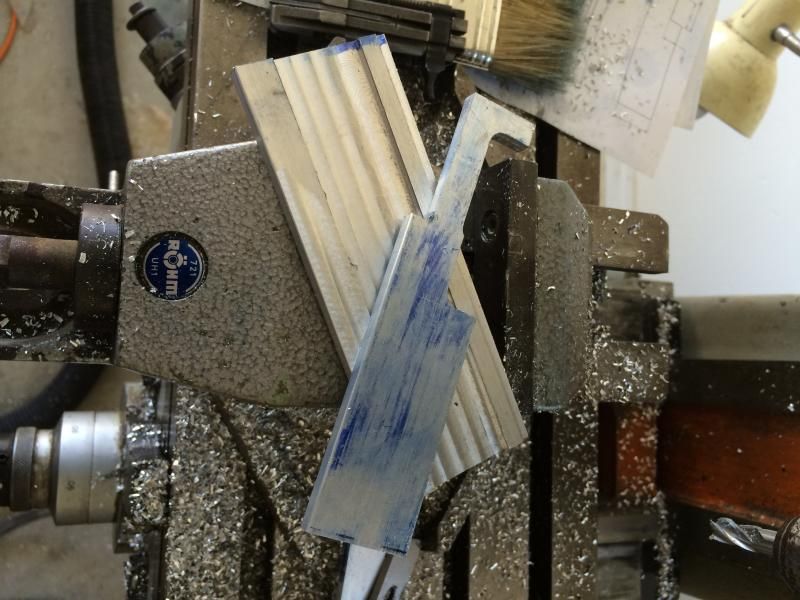

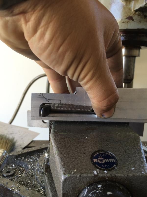

                  I made some progress today. Not sure if this will ever be an actual working receiver, it's more of a first mill project but I'm pretty satisfied with how it's coming out so far.
                  Still gotta mill down the thickness of the side plate a bunch but just getting an idea.
