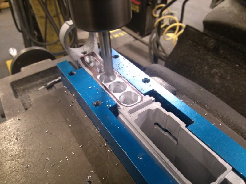

            I move my 3/8 bit right up to the corner (radius) as close as I can with the mill off and then back off a 1/4 turn. I then turn it on and slowly lower it. Then I start at the other end and do it all over. Then I simply connect the dots. I go down about 1/4 down at a time. Your first hole you did on each corner will be your guide so you always return to the same spot. Once I connect the dots I turn it off and return back to the first hole and do it all over again. So go down 1/4" make your hole then raise it up 1/8 and make your pass. So that your hole is always deeper than your pass. It takes a while but it comes out clean. Once you have done your first pass you can take off the plate and do the entire thing without the top plate, that way you never jack it up. Your first pass essentially becomes the guide.
            Second make sure you feed the metal into the bit.
            Check my stats I have some threads, some good some bad on the 80s I have done.
            I also outline the guide with a marker.
            Look towards the rear of the receiver and you can see I scribed the outline into the black.
            Here you can see me following the outline of the first pass like I said above.
