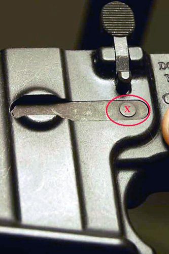

      edgerly779
      • 19871
      drill out the stud that holds the mag release bar from the left side of receiver. Us a center punch to mark center of stud and use a 3/16" bit with a drill press if you have one.

            kendog4570
            • 5180
            This is the best way. Drill and scrap the $5 part and replace it. You can salvage the rest of the stuff when it is out of the receiver.

                tujungatoes
                • 7942
                You need to drill the stud out of the back side of the mag catch Then it'll just fall apart.

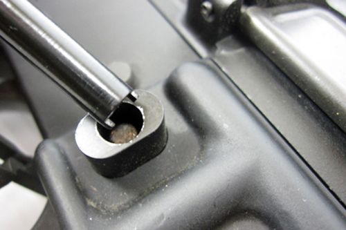

                  I think op may be confused on how to remove/install a Bullet Button.
                  Johnjacobschmidt, Can you tell us what tool you used and how you tried to remove the BB slotted nut? Did you attempt to remove it by simply turning the bolt catch?
                  Originally posted by johnjacobschmidt
                  I am pretty sure that the BB nut that threads on the mag catch is stripped. I though I could pull the mag catch from the left side and force the stripped nut to unscrew but no joy. I tied a tring around it and pulled while turning the nut but again nothing happened.
                  Based on what you've described, it sounds like you're trying to remove the bolt catch from a standard magazine release button.
                  In order to remove the BB, you may need the Bullet Button Installation Tool or something similar. It looks like RifleGear is currently out of stock. Check out the following link to get a better understanding on how the tool works.
                  If it is difficult to remove (with the slots engaged properly), then an adhesive such as Loctite may have been use during the installation. As bigcalidave suggested, use a soldering iron and apply heat to the threads on the bolt catch before reattempting to remove the BB nut.
                  If all else fails and the BB nut is damaged or crossed threaded, drill per the suggestions in this thread. "X" marks the spot. Be careful and seek assistance as needed.
                  An alternative is to the drill from the BB end. The example is illustrated in the following thread.
                  Good luck!

                      kendog4570
                      • 5180
                      Im not sure I understand. What exactly are you drilling?...
                      Right here.
                      Like others have said, don't do it free hand. Use a drill press at least, or a mill is best. If you don't have these, take it to someone that does.
                        johnjacobschmidt
                        • Jul 2012
                        • 528
                        Originally posted by kendog4570
                        Right here.
                        Got it......
                        Took it to a smith and had him mill it off just like you guys said. Thanks for the help!
