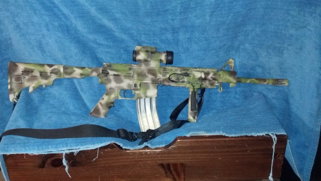

        I used sea sponge cut in 1" cubes to get the patters on these. I basically painted the entire rifle in khaki, then striped in OD green. I alternated the colors opposite of the base color with the sponge.

            I love those ideas... the sponge technique looks awesome. I will try that on my next 80% AR10 when I finish it.

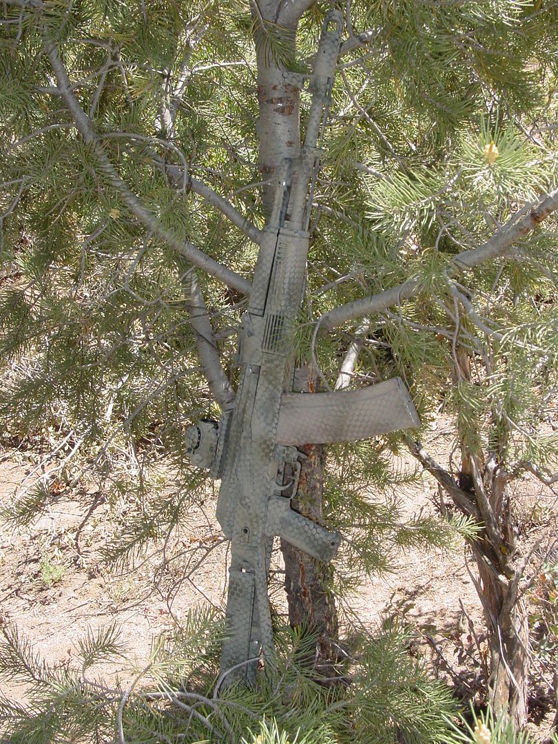

                Holescreek

                  Woah! Those are awesome! How did you do that?
                    wpage
                    • 6071
                    Very cool...
                    Do tell!

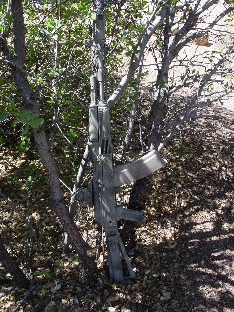

                            After prepping the surfaces paint your base coat on each individual component and let it dry, then assemble the parts that need to match-up.
                            Go to the fabric store and buy rubberized rug backing then over to the craft store and buy spray on adhesive (like is used on post-it notes). Cut the rug backing to wrap around the receiver then spray one side with the adhesive. Once it gets tacky wrap the mesh around the rifle pressing the adhesive into the paint for clean lines, then use some string to sew the edges together.
                            Start spraying your top coats. Don't worry about the backing moving, if it does it just adds interest to the paint.
                            When you get bored, try something fun!

                              • 242
                              Another fun one:
