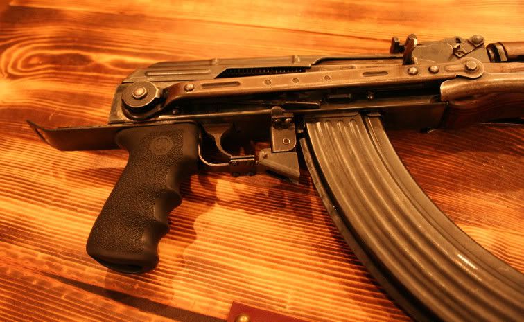

                              Here's my overall look, and I didn't replace the reinforcement plate
