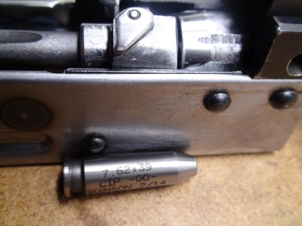

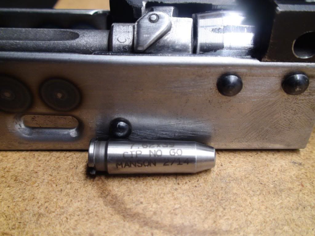

          Pressed the barrel in today, seemed like the barrel likes jumping. Got it close enough, built up pressure on the press. Pounded on the ram with a rubber mallet the rest of the way in. AK master taught me this and it works to perfection. Headspace locks a bit snug on the GO gauge and approximately 1/4" from full battery on NO GO gauge. Does this seem correct or do I need to take further action to make sure? My kids will be firing this and can't afford to take chances.
          Note galling on the barrel, kit came this way from AOA via a second party.
            In my experience, the ones that pop like that are too tight of a fit.
            With a 0.001" difference in diameters, they slide in smoothly right to the gauge.
            Your headspace looks great.
