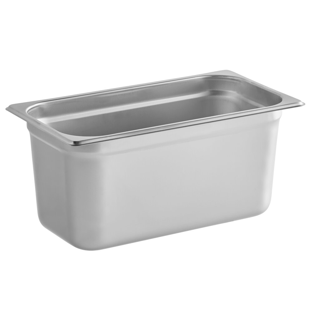

                        massguy
                        • Jun 2013
                        • 38
                        Originally posted by Mojaveman
                        Go to a restaurant supply store or online and buy a stainless steel bread pan and a cooking thermometer. Go to walmart and buy one or two single coil electric hotplates. Go online and order some parkerizing solution. Do some reading online about parkerizing. I was able to get everything for about a hundred bucks and it worked perfectly.
                        Ok you got me thinking about using the Walmart double electric hotplate and a 1/3 size SS Steam Pan for the park solution which has the dimensions Im looking for.
                        Built from sturdy 24 gauge 18/8 stainless steel, this standard weight 1/3 size steam table pan features double reinforced corners that add strength where the pan takes the most abuse. Ideal for use in hot and cold tables at your catering event or buffet, this impact-resistant pan makes cleaning and refilling a breeze. Easy to use and available at a great value, this anti-jam stainless steel pan is a dependable addition to any kitchen! This hotel pan has built-in, anti-jam stacking lugs to enable hassle-proof separation and easy lifting of the pan. Plus, it can go from freezer to oven to serving line without bending, which ensures that it will sit flat in steam table wells and hold its shape under the toughest conditions. Overall Dimensions: Length: 12 3/4" Width: 7" Depth: 6" Brimful Capacity: 6.1 quarts
                        I can get a cheap pot to fill with distiller water for the preheat.
                        What oil can I use? Do you need to submerse it in a container of oil or can I just spray with some gun oil or CLP breakfree?
                        Not sure what is a good thermometer to use - any links to suggested ones?
                          Mojaveman
                          • 1179
                          I sprayed WD-40 on my parts after removing them from the solution. I used a dial faced cooking thermometer like the kind you would stick into a turkey while cooking it. You can fashion a holder for the thermometer from some wire so that it sits on the edged of the pan. 195 degrees give or take a few will work. What's most important is that the metal is CLEAN.
