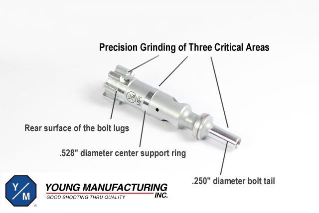

        Young's Manufacturing makes a big deal of not staking; they clean and torque and some Permatex. Might try that.
