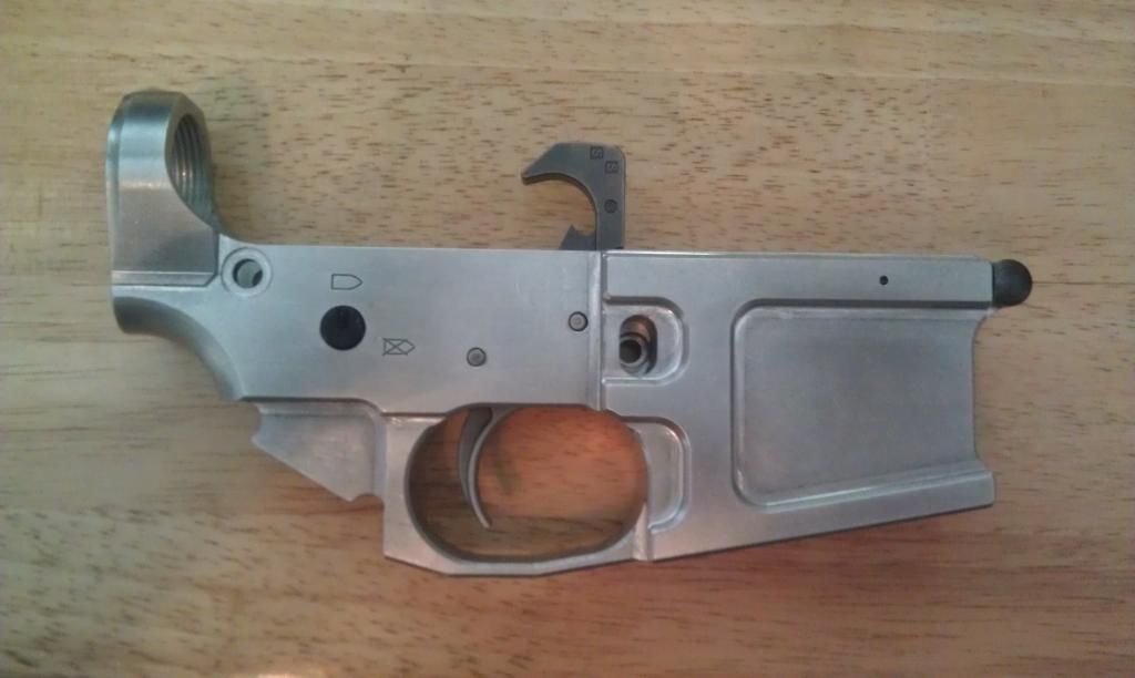

      Here's a couple pics of the FCG pins. If the hammer pin is out of spec, it can't be by much.
      [IMG][/IMG]
      A little closer
      [IMG][/IMG]
      Good quality FCG by ALG:
      [IMG][/IMG]

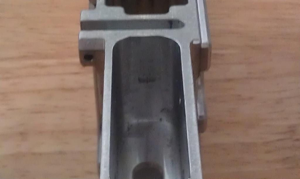

      Spot where base of hammer rubs against front of FCG pocket in lower receiver.
      [IMG][/IMG]
      Would the pressure of the friction on the base of the hammer be enough to slow the rotation of the hammer and prevent the sear surfaces from catching?
      Should I grind & polish just the spot where the hammer is rubbing or put it back on a mill and expand the whole pocket?
      I saw the nightmare drill press pics from another post & don't want to cut into the mag release pocket.

              vw69turbobug
              • Oct 2009
              • 280
              ^^ what he said if i remember correctly it should be around .1050-1100 in thick
                croc4
                • May 2005
                • 569
                looks like the right wall is thicker than the left.
                Take dremel with a sanding drum on it and go over the problem/ contact areas, should solve the issue. I had a similar issue on one of my very first lowers I did.

                          *Problem solved*
                          I beat up the hole for the hammer pin test fitting my LPK.
                          This caused the hammer to wiggle in the now out-of-round hole. Spring tension caused the base of the hammer to rub against the front of the fire control pocket. I could feel this friction. While working the hammer. While troubleshooting the problem, I was inadvertently causing the hammer to lever against the pin and lower, making the problem worse.
                          I wound up with an out of spec lower due to my own ham handedness.
                          Anti-walk pins (with the external arms) could have fixed the problem, but I opted to start over due to the safety issue and for some peace of mind.
