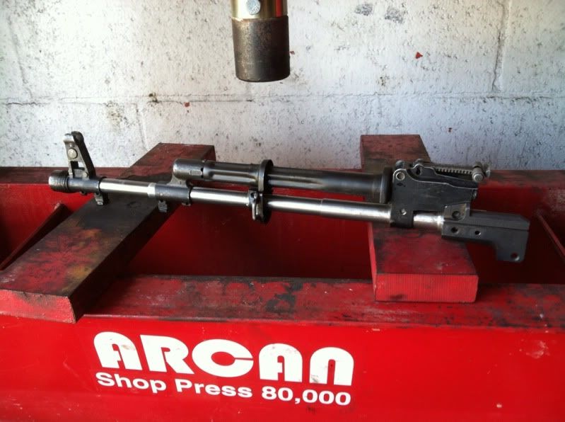

    Need AK74 barrel components drilled and pinned!
    I managed to headspace and install parts on the barrel myself with use of a giant press. I drilled and pinned the RSB but am concerned about drilling the smaller parts and barrel pin. Can I do these on a drill press? And special drills recommended?

                A drill press is fine to use. Clamp the work down. Trunnion is a 7mm bit while the gas port is a 2mm.
                Going off of your pic, your going to have to first mark the location of the gas hole from the bottom and centerpunch 180 to top centered, than slide the gas block forward in order to drill the hole at a 90 degree. Follow that with a slight tap of a 3/16 bit to make a chamfer.
                Pins are 3mm. RSB is 4mm

                  Thank you. Gas port is drilled already.

                          You are correct. This thread was originally me looking for someone to headspace/populate the barrel for me. I originally posted in the WTB section and had no replies so i re posted here. I got around to trying it myself and did pretty good. Now I'm asking "how to" drill and pin the parts. I wanted to be sure I was doing it right so I didn't mess up the parts drilling them. Thank you for your concern.
