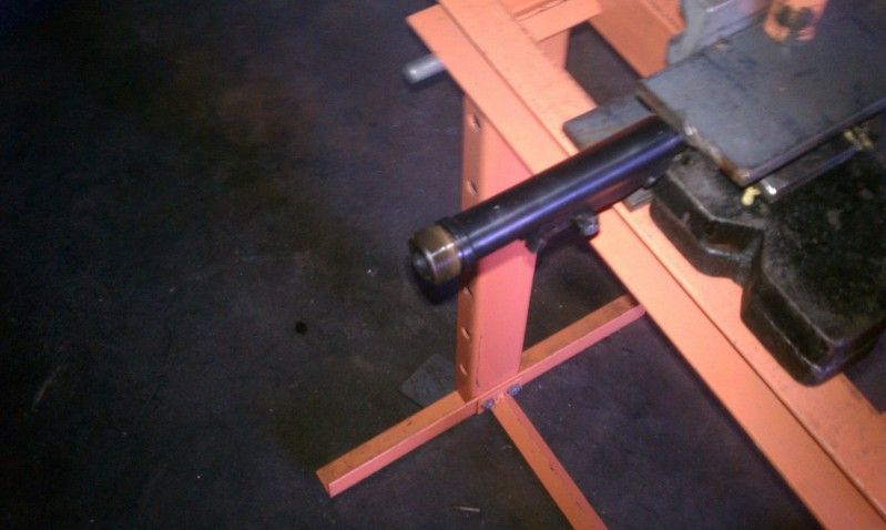

    Originally posted by jbl_1967
    ... I have hit the end with what I can do at home.
    Is there anyone in the Bay Area, or close by, that can help me out with this one?
    Thanks!

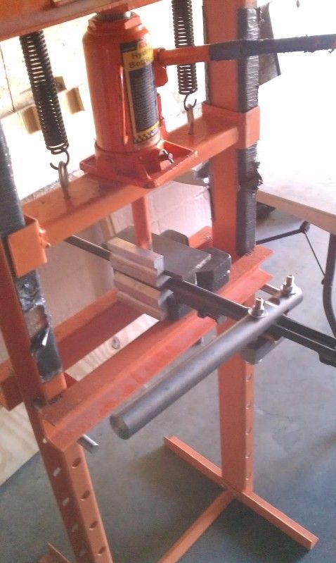

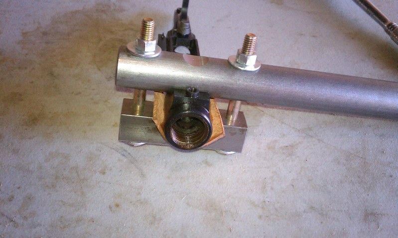

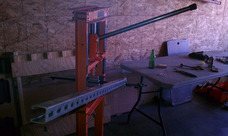

      You are on the right track.
      There is more than one way to skin a cat and this how I do my Mausers.
      First tip.
      Soak your barrel threads for a day or so with penetrating oil.
      Use a piece of think leather and locate your receiver wrench as close as possible to the end of the action, you'll be able to apply the torque with out deforming your receiver.
      I use a hydraulic press (since I have one and I can actually secure my barrel jaws much better and prevent any movement).
      Leverage man, it's all about leverage.
      Did you noticed the 4 ft. long cheater bar attached to my receiver wrench??
      *Edit. and the brewski on the background...ooops.
      One quick movement and...... you'll be able to set that barrel free.
      Intact threads, perfect and undamaged action
      Good luck and enjoy your project.

        First tip.
        I soaked it 3 days
        There was maybe 1/2 an inch between the barrel vise and action wrench
        I considered picking up a press. I am not sure what else I would use it for, except maybe building AKs, which is a money pit I have avoided so far.
        I didn't have a 4ft bar on the wrench, but I did have a two foot handle and was put several hundred pounds of force on the handle.
        Love the home made action wrench.
