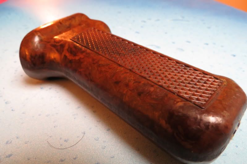

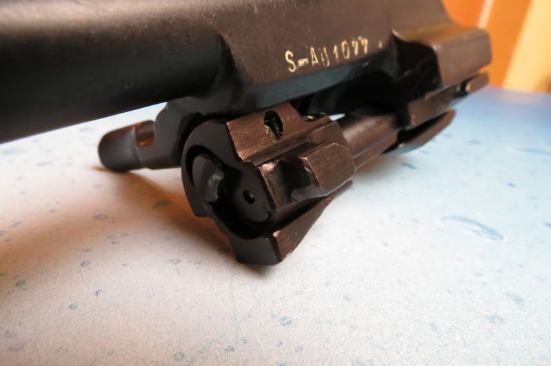

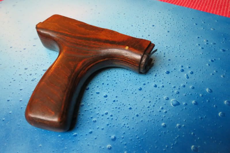

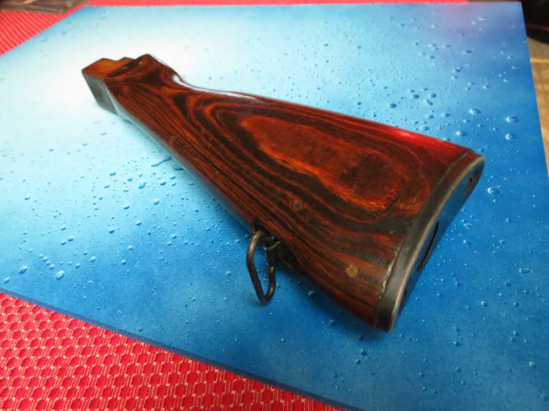

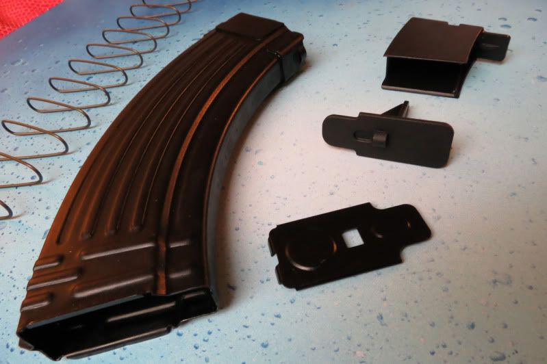

    I have recently purchased my first ak [parts] :
    Romanian AK-47 parts kit w/ virgin US barrel (gas port drilled)
    Bullet Button
    Bulg. 30 rnd rebuild kit and 10/30 mag plug
    Tapco FCG
    US slant brake
    Rivets
    and various accessories - front sight adjust tool, leather sling, bayonet)
    My Question is how much can I get done before I save up and DROS a receiver(NDS-1 EZ)? Would it be possible to head space and drill/install barrel pin without the receiver?
    My goal is to have the least amount of work to do when my receiver comes in.
    I have already parked a bbl for my retro ar build so Im not worried about that. Also my kit seems to lack a shepards hook so I will probably just get the "retainer plate" style one. Anything else I'm missing?

      And yes if you have the tools or send the barrel, bolt, and front trunnion it can be head spaced ahead of time.

        And I cant headspace even if in building on a receiver with pre drilled trunnion holes?
        What tools will I need? Will a vise, drill press, and mallet get the job done? I say mallet because the barrel and trunnion don't have a suuuuper tight fit like i see in most build videos where they are using a Euro barrel.

            If you have the tools or send it out. YES you can. the barrel will have to be removed from the trunnion to rivet to the receiver and then the barrel reinstalled and headspace checked.

              First off get the barrel headspaced and populated, the receiver is NOT necessary for that. Nicoroshi on here is my go to guy for that.
