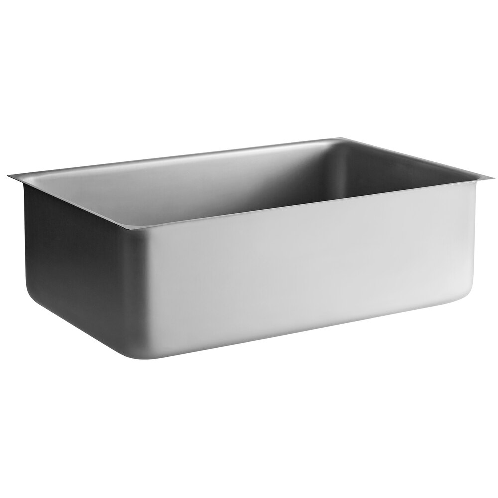

        I'm putting together a kit to park my M1919. Check these links for the tank and burners. The restaurant supply place also has thermometers.
        If you operate a high-volume restaurant, cafeteria, dining hall, catering business, or other foodservice establishment, then this Vollrath 99765 6 3/8" stainless steel full-size steam table spillage pan is an ideal product for you. Use this pan to save money in your commercial establishment. Featuring a durable, 18-8 stainless steel material, this spillage pan conducts heat efficiently and will keep food hot and appetizing throughout your entire service. The corrosion-resistant, stainless steel construction can withstand the high volume needs of your kitchen or buffet line, so your offerings can always look full and abundant for your guests!A full-size steam table spillage pan is an essential item for any foodservice establishment. The 6 3/8" deep design will fit into your steam table with ease and accommodate a standard full size steam table pan. Foods such as vegetable lo mein, roasted garlic and herb potatoes, and hearty winter stews will retain moisture perfectly! Simply fill this spillage pan with hot water and place your food pan on top. Rounded, diagonally tapered corners make it easier for cooks to pour out liquids and foods into storage containers. Use this with adapter plates or insets on your buffet line or use in your back of the house for bulk storage. This dependable, easy to clean, versatile pan is an excellent addition to your buffet line, catering business, and kitchen.Overall Dimensions:Length: 20 5/8"Width: 12 5/8"Height: 6 3/8"
