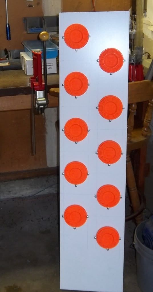

    Simplest target I ever made.
    Had a few drinks after work and went to the garage. This is what I ended up with using the 1 1/4" panhead screws and an old shelf. P.S... Panhead is the actual name of the screw...NOT a racist slur. Just wanted to clarify that... My last girlfriend was Vietnamese...Cute little thing, But what a B... Anyways...
    The side screws (There is that word again...) are just slightly below center of the clay (1/16th") and tentioned so the other clays won't pop out when one is shot. Made it for dueling colts or a CA semi auto rifle. Can't wait to try it...

    Great idea!. I've had the thought of taking my router and making slots or grooves in a 2x4 and standing them up.
      diginit
      • Feb 2008
      • 3250
      I thought about that too. But unless there is a clamp of some kind on each clay, The others will fall off on a hit to the 2x4 unless the router is tight and angled to fit the clays and tilt them slightly rearward. So they balance upon impact. Hard to do... Plates have more weight and won't fall on a hit to the 2x4. If the router is deep enough...But dishes cost more than clays. And are not biodegradeable. Holes don't hold clays tight enough and too many clays hit the ground with a near miss. This is the best I have come up with so far. The clays are held tight. And will likey decentigrate more when the bullet hits the board and it is splintered. I'll let you know how it goes. This is another test...

                  OP why don't you hole saw out most of the area behind each target, that way it should last a lot longer. Most hits on target will go right through, breaking the clay but not destroying the board.

                      coulnt you do the same with screws at 4 and 8 o'clock i'd also put a bit of rubber or plastic tubing like say fuel line cut in little half inch sections on the screws
