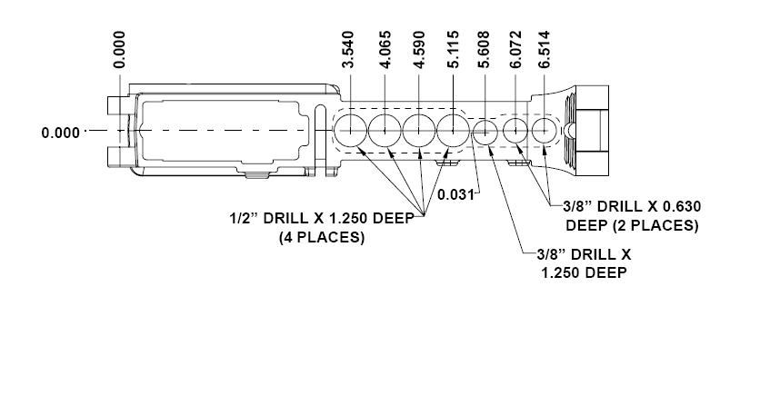

                        Just thought I would update this thread as I have completed #'s 3,4 and 5.
                        Drilling out the pocket first really is the way to go. Perhaps using a different type of end mill would negate this, but it is pretty quick to drill some holes in the pocket to within .10" of the final depth then come back through with a roughing end mill followed by finishing cuts.
                        I really don't use the jig much anymore. I use it to mill out the first outline and set the starting point of the trigger slot. Other than that the calipers and micrometers guide me.
                        I drill 4 1/2" holes in the FCG pocket, 1 3/8" hole in the narrower part of the deep pocket and 2 holes in the shelf. No plunging which seems to be easier on the machine and bits.
                            I really don't use the jog much anymore. I use it to mill out the first outline and set the starting point of the trigger slot. Other than that the calipers and micrometers guide me.
                            yep.
                            drilling removes material much faster, easier, and with less stress on your machine and setup than plunge- or side-milling w/ an EM.
                            the Ray-Vin method is your friend (although to avoid a "cratered" FCG pocket floor, stop well before 1.250" & 0.630" when drilling, despite what the drawing says)

                              Hmm, My drill press is a small benchtop and would suck for drilling these holes. Maybe just write a CNC routine that drills the holes for you and use a drill bit instead of end mill in the mill itself? Then you just go through and rough out your lowers with the drill and then switch to end mill to finish them.
