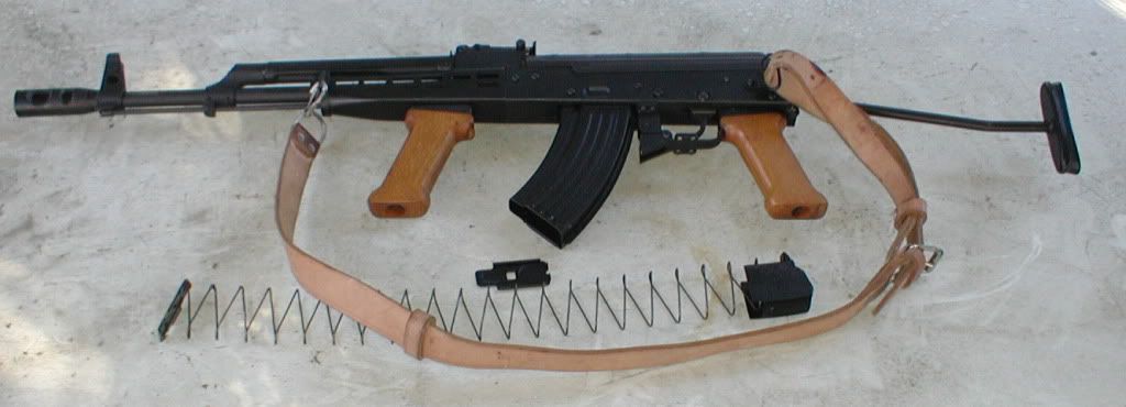

      Reworded OP. Basically, I want to purchase a draco And convert it into something like this, Minus the forward grip.
