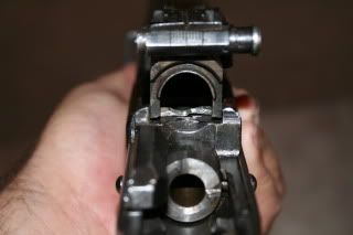

    Here is the issue we ran into. The Bolt carrier was hitting the rear sight block. The area just after where the piston and the bolt carrier are riveted together. None of us had seen or even heard of the problem before.
    Here is a picture with the fix Justin came up with. At first, the idea was to use the shim to reduce the amount of grinding and or polishing that would have to be done. The grinding and polishing was our first and only idea before Justin thought of the shim.
    The shim is a peice of 1mm receiver cut into a rectangle and shimmed between the rear sight block and front trunnion. The shim was then ground down in the middle to provide clearance for the bolt carrier.
    Big thumbs up to Roccobro for hanging in to midnight helping me with this problem.

    So what's the barrel look like after fitting it to the various blocks? Did you have to lose a lot of the OD at the ribs to get the RSB on? I have an M72 barrel I was thinking about using for one of Romanian RPK build if the US barrels don't materialize anytime soon.
      -MRA
      Here is a picture of the barrel. You're going to have to lose some of the material on the cooling fins to get the Romanian Rear sight block and hand guard retainer over them.
